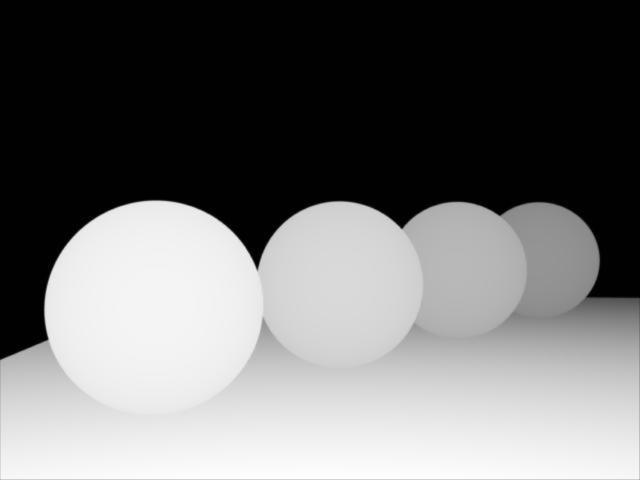

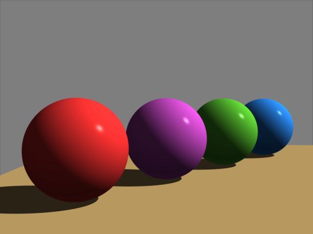

    You can make your own Depth Matte in Carrara and control the values using Distance Fog, it just takes some steps to set up and tweak. This method also allows you to control the render quality. I set the AA to Best and Object Accuracy to 1. We aren't rendeing shadows, so I left it default 4.
    Here we go:

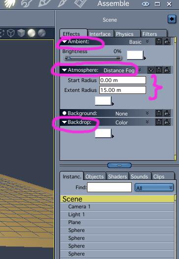

    1 - Turn off ALL your Lights, including any Ambient Light
    2 - In the Scene Effects Tab, turn on the Backdrop and set it to pure white
    3 - In the Scene Effects Tab, under Atmosphere, turn on Distance Fog and set it pure white.
    4 - Set your Start Radius to 0 and Extent Radius to whatever is the furthest point in your scene. These are the controls you use to adjust the values to taste.
    5 - Render.
    The first Depth Matte example goes from 0 to 15 meters. Second one goes from 5 to 15 meters. You'll have to 'guestimate' based on the distances in your scene and what kind of value range you want.

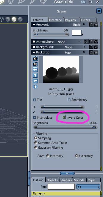

    The result goes form dark to pure white. It looks like you need the reverse here. Easiest way is to bring it into your favorite image editor and simply invert it and save it out. But since this Carrara, we can do it internally with a few more steps.
    Turn the visibility of all your objects in your scene off. Turn off the Distance Fog. Set your Backdrop to Map, import the image you just rendered, and check 'Invert Color'. Render.

    @DesertDude, does your technique result in occlusion (the effect is most obvious under the furthest ball), or is it a visual/perception artifact?
    I ask because this would sort of pollute (is there a better word?) the accuracy of the depth info, right?
    Hmmm, I'm not sure... Are you talking about how each sphere is a little bit lighter as they curve away from the camera? I just did a quick render using Carrara's native Depth Matte and I think I see someting similar. This is a super old school technique I picked up from 'another software'. It really just allows more control of the range of values without having to use an external editor.

    I see this fog trick as a great depth mechanism, but if scene 'light' is doing light-ray like things in concert with the fog effect, I could see it having an impact on the 'purity' or accuracy of the depth info we'd be looking for. In this 3D/stereo effect, it might matter.
    The occlusion effect helps make 'corners' look more correct as the light is absorbed differently in corners. It also occurs where two things meet, like the balls and the plane. In the negative result, you can see a slight 'glow' right near the bottom of the ball, and if it were pure depth information, I don't think that would be there. It's probably a mix of fog/light(?) in this case. It could be an optical illusion though - hence my question for anyone who might know.
    In DS you have to fight to even get real occlusion, so I bet in Carrara, you can turn it off (in the lights or the renderer?) and the issue goes away. Anyone know? If so, we can add that to your recipe for an even more accurate depth gathering hack!
