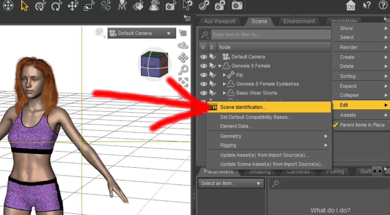

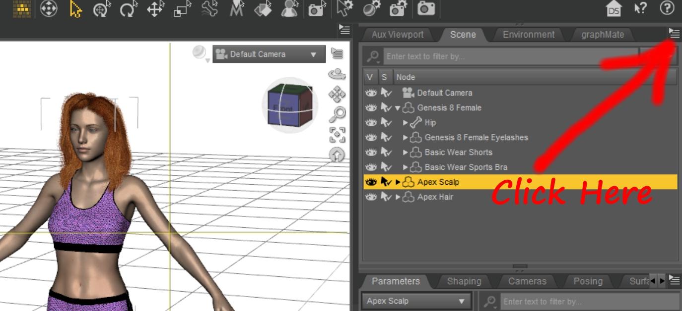

    Sure, load your GF3, then make sure you ARE NOT SELECTING the figure and then load the hair you want to use. Then while in the scene tab and the hair selected, go to the four little lines in the upper right of the scene tab and select EDIT - SCENE IDENTIFICATION and change the figure to genesis 3 female and save. Now it will fit to Genesis 3 female just like it would with genesis 8 female and you can now run a simulation.

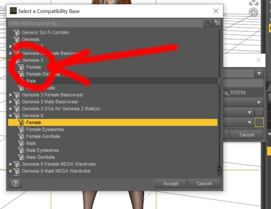

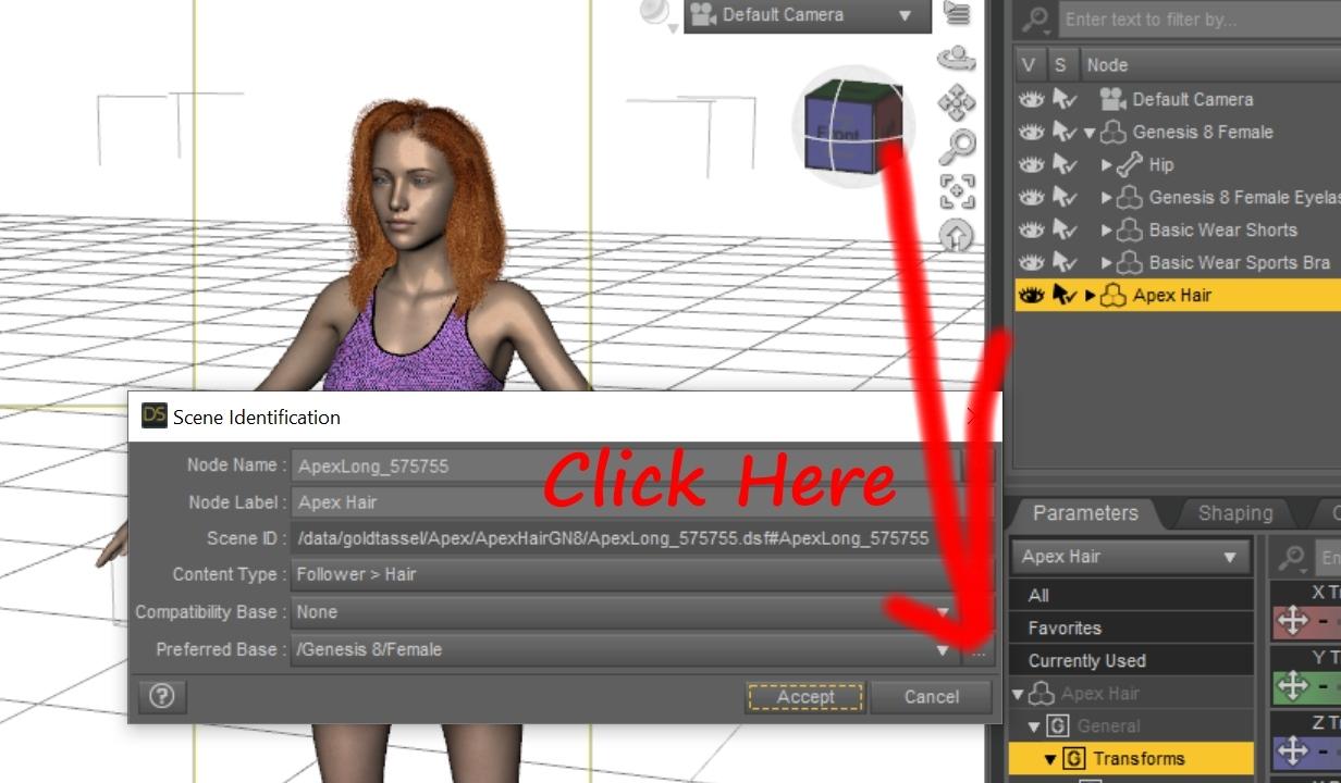

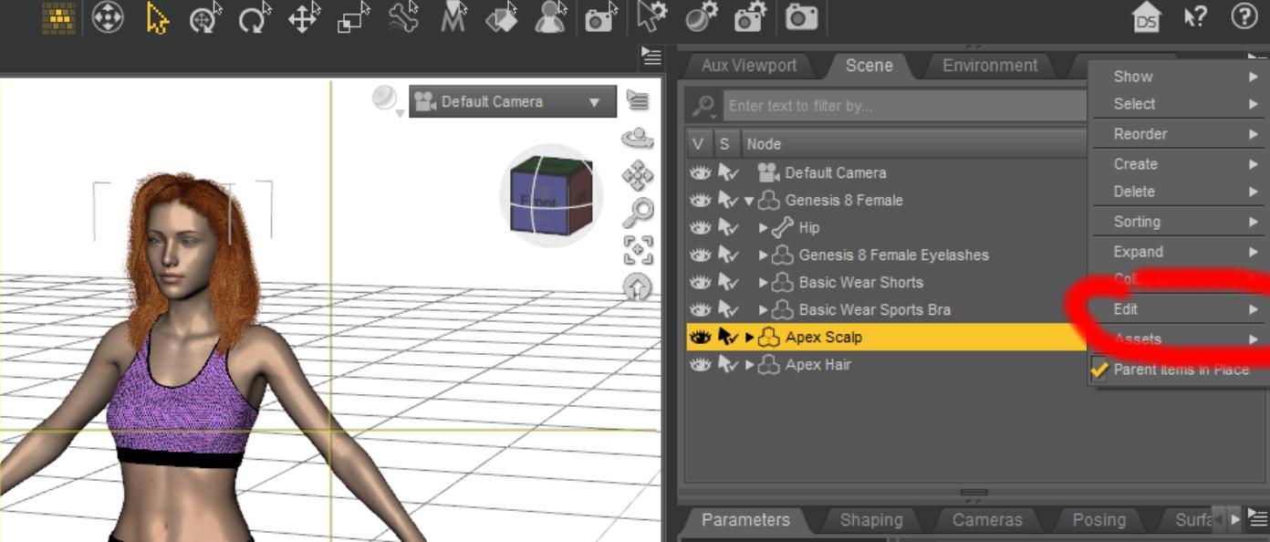

    Yes, they will work on G3, as long as you don't "Fit to" the G8 hair.
    There are two ways:
    1/ Parent the hair to G3's head, adjusting the position and scale manually. or
    2/ Select the hair only, then change the Identification from G8Female to G3Female with this method:
    (In image 4, make sure you click on the '...' )
