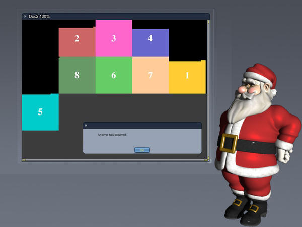

I look through this forum and found a post by Stezza from 2012 that said: "I could never get 3DU Toon Santa to work in 8.1 or earlier but so far in 8.5 it is working with this simple workaround. This didn’t work for me in all previous public releases so something has changed in the 8.5B". Stezza had a workaround, but I didn't understand it.
Next I tried using DAZ Studio to open Toon Santa and then export it in a collada.dae format. That seemed like an okay workaround -- except for one problem. It seems that DAZ Studio exported Toon Santa as a scene. Once imported into Carrara, I don't know how to turn it into an object that I can save in Carrara format.
Is there a way to do this, or do I need to go to 8.5? I'm hoping somebody can help -- I'd like to get back to PhilW's DVD.

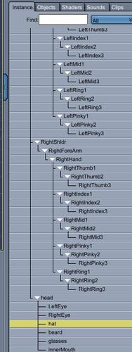

    did you follow the instructions in the image?
    Load Santa PS
    When loaded, Santa is missing several objects..
    1. his pom pom
    2. his glasses
    3. his belt buckle
    4. the fringe of his coat.
    Select each missing item from the instances tab on the RH side and then on the menu bar at the top select Animation—-> Set IK & Constraints then untick Change the IK setting.
    Just checked it in 8.1 and it works as in 8.5 ;)
    Hope this is a bit easier to follow for you :-)

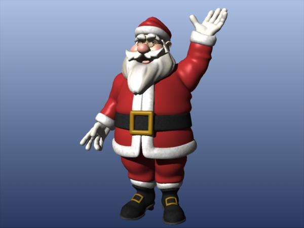

  • StezzaStezza Posts: 9,215
    Just rendered him to show
    here he is with all parts :)
    in 8.1
    640 x 480 - 96K

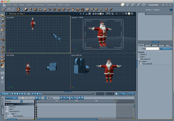

  • craig_b2717bf573craig_b2717bf573 Posts: 3
    Dartanbeck - Thanks for pointing out the online Carrara manual. It didn't show up under Menu > Help in 8.1 (at least not on my mac), which may be why I missed it. But I did find it on your excellent "Carrara Information Manual" post. I'm sure this will be useful as I go along.
    Stezza - Thanks for your workaround to this weird problem file. Following your instructions, I got it to work okay!! Here is what I did.
    1. Opened a medium empty Scene
    2. Selected Content tab in Browser tray
    3. Click black button at right end of Browser tray
    4. Selected "Add Runtime" manual not auto
    5. Navigated to folder containing the Toon Santa runtime
    6. Clicked Open, and it appeared under in Content tray
    7. Dragged Toon Santa from Content tray to empty Scene
    8. At this point Toon Santa is missing pom pom, glasses, belt buckle, coat fringe
    9. Follow your instructions: Select each missing item from the instances tab on the RH side and then on the menu bar at the top select Animation—-> Set IK & Constraints then untick Change the IK setting.
    Everything now works correctly. I can pose, render, and save as .car file. I wonder how many more DAZ content files have this problem?
    I did a little testing and found out that the render crash I had experienced previously was caused by the missing items. If I stopped at step 7 and tried to render, it crashed. If I did all 9 steps, it did not crash on render.
    One downside is that I can't seem to make the fix permanent. If I reopen Toon Santa in a different scene, I have to re-apply your workaround. Of course, I can save the fixed version as a .car file and then import it into future scenes. Any thoughts on this?
    Again, thanks to both of you for your help.
    1180 x 826 - 291K

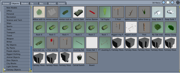

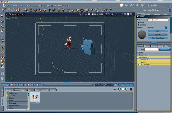

    I just read your article about making "My Carrara Content Storage System" in Carrara Browser -- it's Totally Awesome! I had no idea that "My Objects" in the Objects tab linked directly to a specific folder.
    On the Mac it goes to: Documents > DAZ 3D > Carrara 8 > My Presets > My Objects. To test it, I added a subfolder called "Toons" in the My Objects folder, then copied in "Toon Santa FX.car" file. I fired up Carrara, looked in the Browser tray -- and there it was listed under My Objects > Toons. Unbelievable -- it worked the first time.
    Question: In the Browser tray it shows a default image for "Toon Santa FX" instead of thumbnail. I tried copying the "Toon Santa.png" file into the My Objects > Toons folder -- it didn't work. I also tried renaming the .png to "Toon Santa FX.png" so it would match the .car file -- that didn't work either.
    (see problem in attached photo)
    Any ideas on this would be much appreciated.
    1175 x 769 - 307K
    Try dragging the Toon Santa FX from the instance tab and dropping it into the Objects tab... It will then save a thumbnail of it ;)
    "Dragging it from the Instance tab and dropping it into the Objects tab" worked great.
    Thank you Stezza

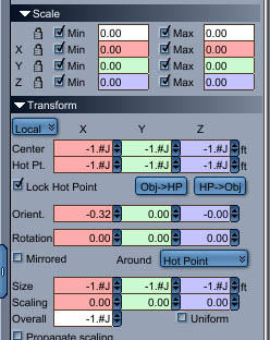

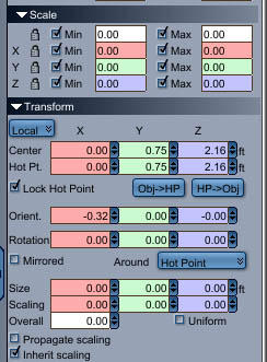

    It's not the IK that's broken (that's why you're un-checking it), it's the scale. In the CR2, all of the scale dials have min and max both set to zero, which Carrara doesn't like. If you look at the"un-fixed" toon santa, you'll see that the scales are all zero and the limits are all zero. You can't fix it by hand, either - Carrara will just throw an error.
    And this is in more pieces of content than I really care for, honestly.
    Things Carrara doesn't like:
    - ERC links that use the display name instead of the channel name
    This causes dead morph dials. CorVas's "Simple Details", the "Perfect V4" series, and Aery Soul's "Alice" all have this problem
    - "otherActor" links to bones that don't exist
    Most often in clothing. The ususal symptom is that when you conform it, some parts of the clothing will stay put even when you move the base character (most often the hip). Royloo's A3 Kimono does this.
    - Bad constraints
    Carrara actually cares about the "min" and "max" entries in the CR2 file. It is not at all unusual for Poser stuff to have both zero, both one, or in some cases bizzare random numbers - especially in the scale. Figures will be invisible, or come in at some weird size. Bounding boxes will stretch off to infinity and "An error has occurred" will often occur. When this happens, check the "Motion" tab and see if it's all zero, very strange numbers, or weird things like "-1.#J", "#INF", or "#DEN"
