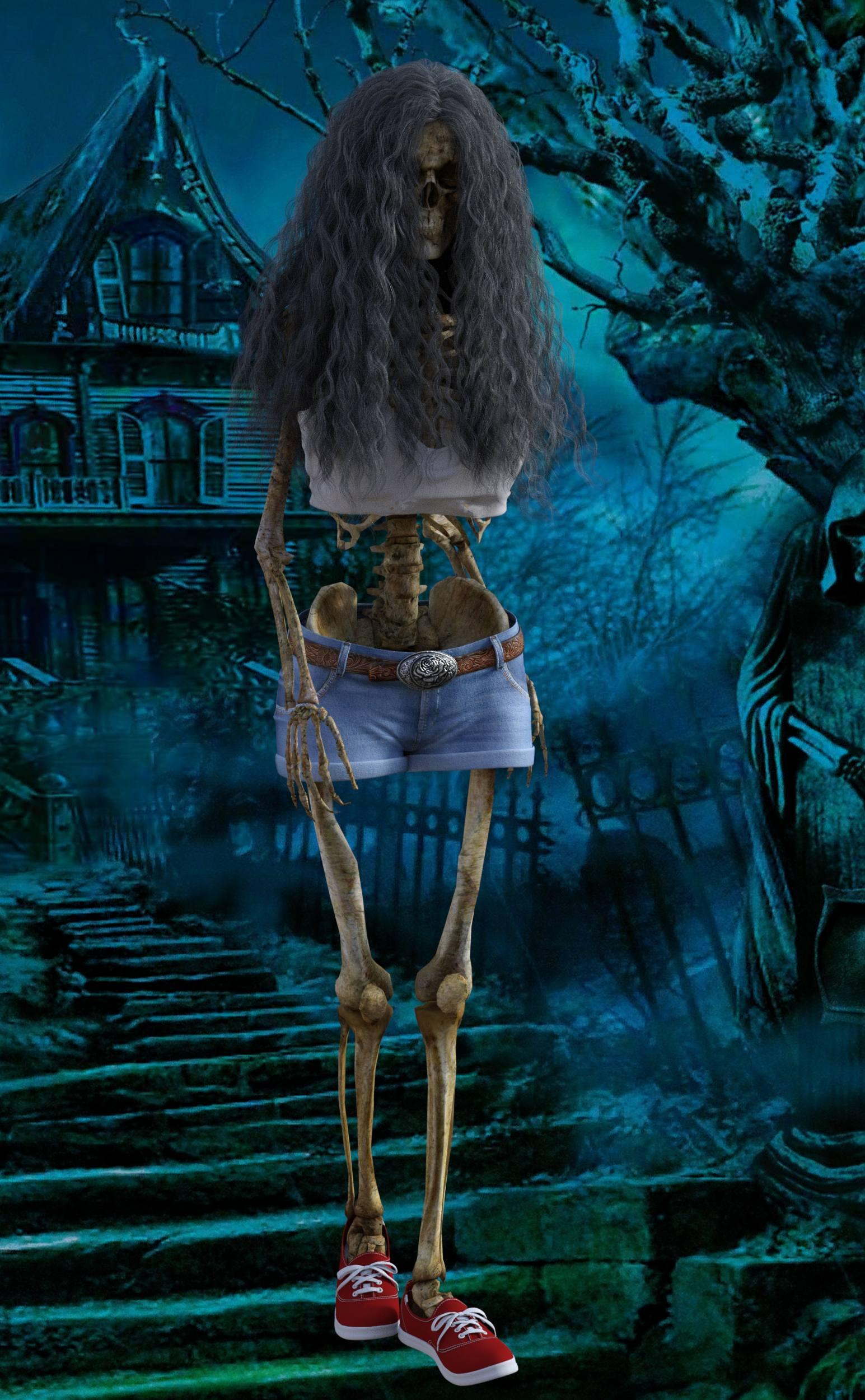

    How fun the v4 skeleton.
    This is v4 Skeleton as a wearable for Genesis 8
    I fitted the v4 skeleton to genesis first then  I fitted the skeleton directly from genesis to Genesis 8 female using the autofit tool  then shut of the visibility under the display tab, then I saved it as a wearable i haven't tried the organs yet,.
    I made this render using Lindsay deforce long curly hair  and some Rpublishing fades country clothing
    1545 x 2500 - 421K

    Ivy, do you know how to fix the femur and humerus bones? Your render still has the issue with it. Will rigidity maps work?

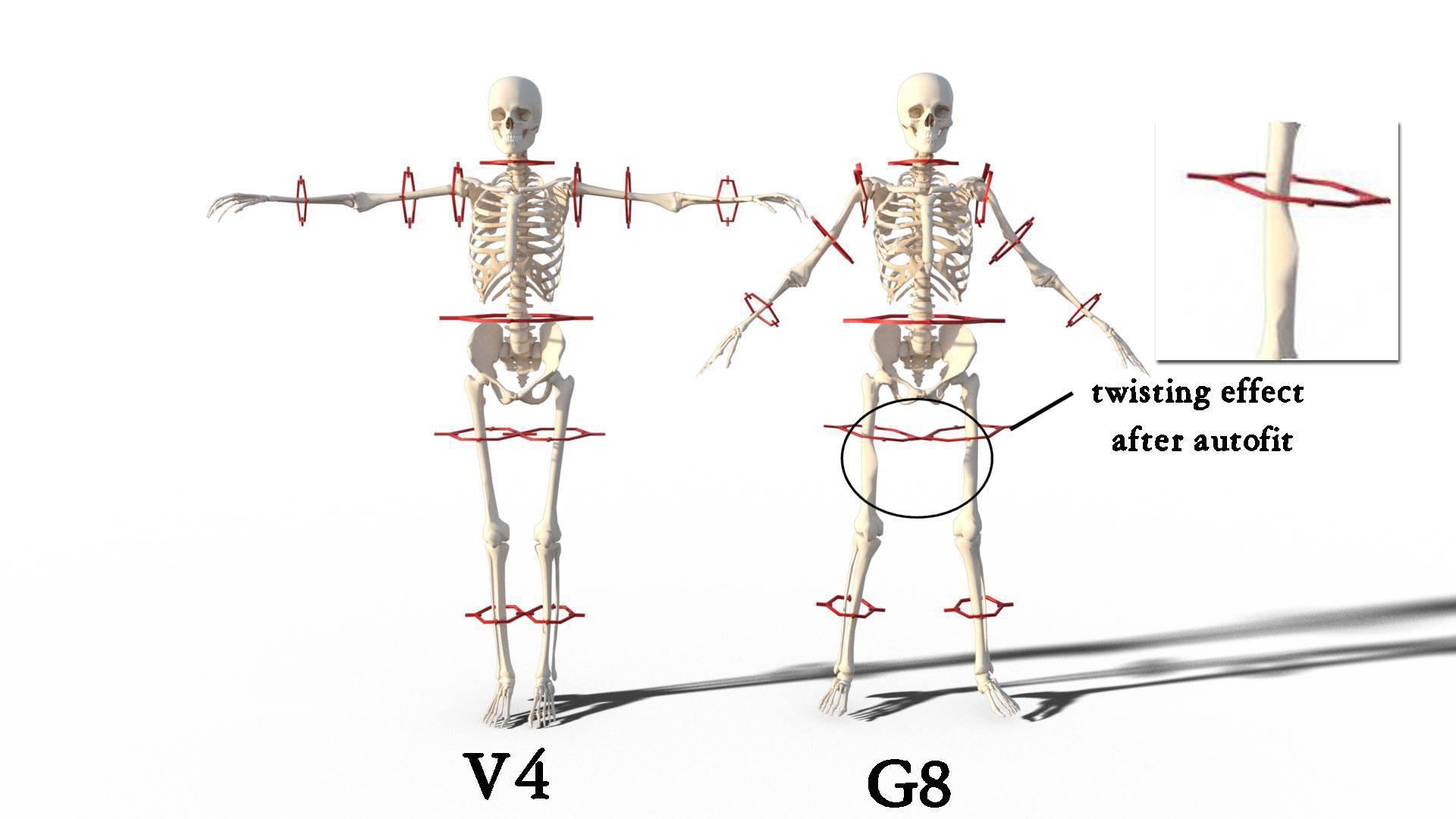

    I think there is a little twisting to the legs and upper arms during autofit because of the difference of the 2 character mesh structure. But it never bothered me because i thought it kind of it adds to the old bones look. but I would properly use the deform tool and reshape it if it was a issue for a render.
    1920 x 1080 - 111K

    Thanks. I'll try the d-former and see if I could fix the twisting of the upper arm and thigh. I'm expecting a lot of work to fix something that already looks fine at an angle. I'll also chop off the excess thumb that protrudes or just hide it.
    I always forget that G8 has clones for G1 and G2. Going from V4 -> G1 -> G8 produces less twisting compared to jumping through all generations.
