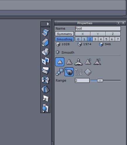

    You got several options you can play around with. ;-)
    434 x 494 - 29K
    727 x 120 - 27K
    Also, in the Vertex Modelling tab, select Edge Around Edge as shown, that will keep the edges sharp. You need to extract the edges as close as possible to the original to make them really sharp.
    The cube below has had Smoothing set to '3', and it is still cube like (just to demonstrate. I didn't get the edges really close though, but it has still worked.
    772 x 630 - 240K

    JimmyC's suggestion works fine in many cases.
    You can also use "dissociate", which breaks your mesh at the selected vertices. You might run into other issues with this, like messing up your UV map.
