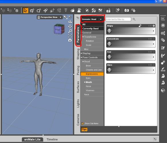

    You need to select the head of Genesis, then on the parameters dialog you should see "Pose Controls." Expand that and you should find expressions under it. Don't remember how many expression are in the starter essentials, but there are mouth controls there too.

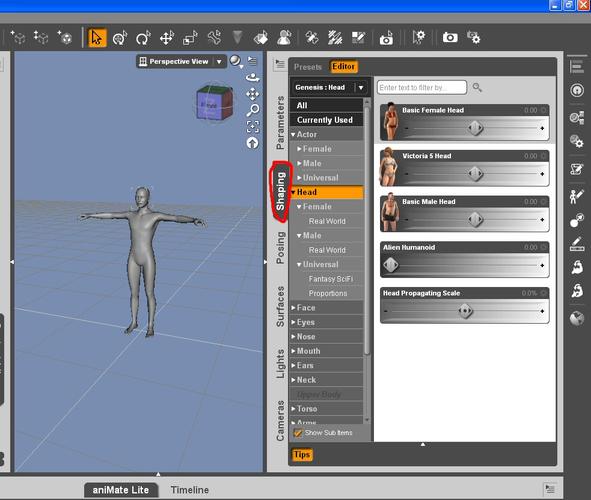

    Re the Genesis facial expressions, if I select 'head' all I get are Basic Female Head, Basic Male Head, Alien Humanoid and Head Propagating Scale controls. Under Face I only get Jaw Size, and under Mouth I only get width and height. So this is still a mystery.
    It seems I need to upgrade both PC and video card, though I have managed some scenes (still incomplete re lighting) with 3 characters and a lot of extra furniture and fittings.
    This sounds to me like you are in the Shaping tab rather than the Parameters tab.
    If you don't have a Parameters tab anymore, go to the menu Window -> Panes (tabs) -> Parameters to bring the Parameters tab back.

    I have attached some screen shots from my old computer system. This is DAZ 4.5, but there is almost no additional morphs and content installed on this system. The first one shows the genesis head selected on the parameters tab and where the expressions are under the pose controls.
    The other one shows the shaping tab with the head select. The shaping tab shows items like you are describing, which is why I think you are looking at the shaping tab.
