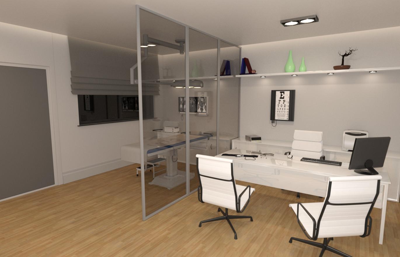

  • Thank you both! Sorry I didn't check back sooner.
    I can't believe I didn't think to try a render! But I think the tips from your 2 posts will solve the problem. Will be doing some more work on it tomorrow afternoon and will report back.
  • edited February 2019
    Just started rendering, but it looks like turning on the scene lights & changing the Headlamp Intensity settings to 1 for cameras 1-6 did the trick. I did turn off the headlamp for Camera 7 before I rendered through it. I didn't change any of the settings. I may remove a wall or ceiling if I decide I don't like any of the camera presets--or want to replace the window/door wall with just a plane. I will edit to add the image once it finishes rendering.
    EDIT: added test render. Now to actually do my scene.
    556 x 444 - 165K
