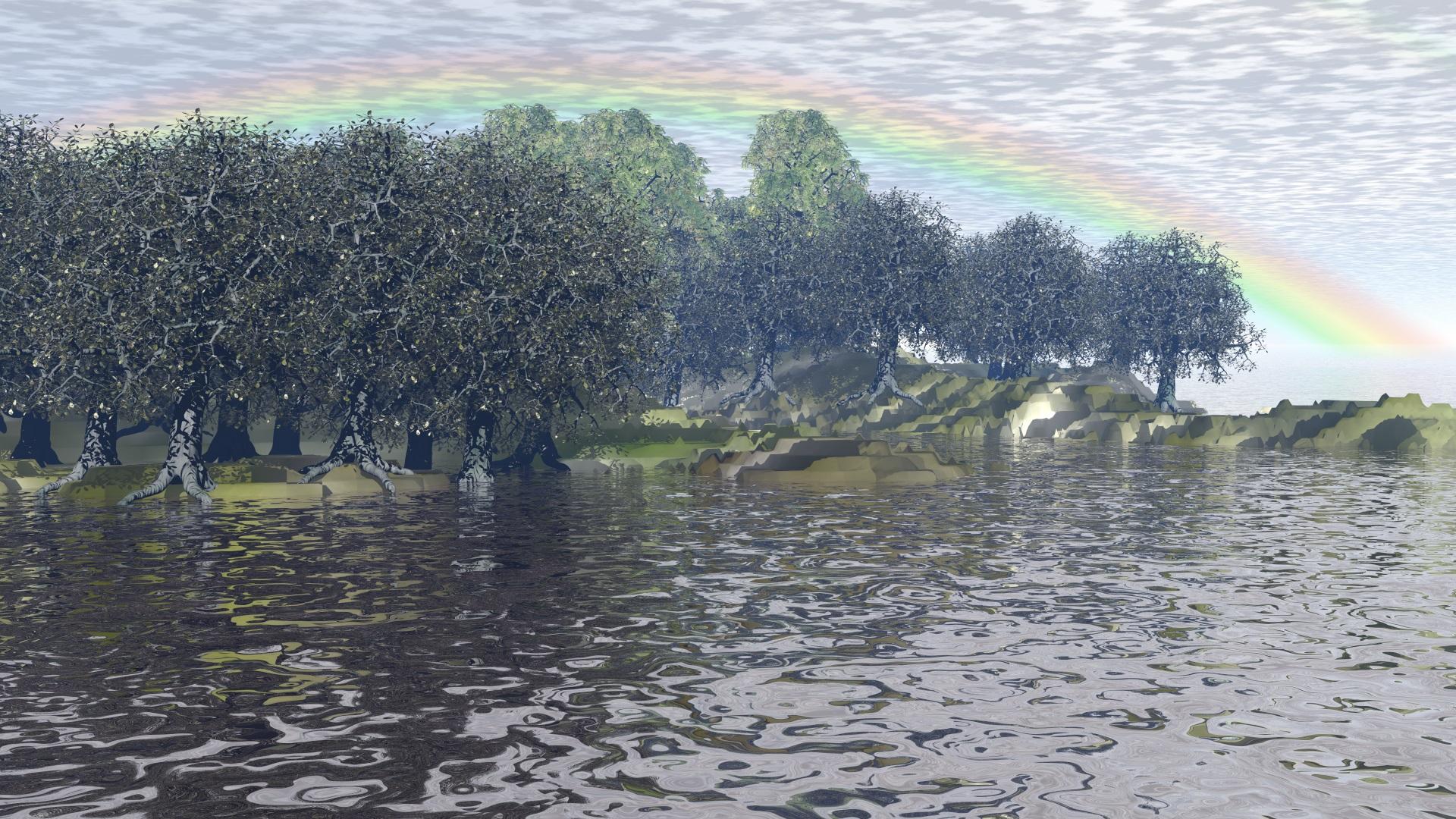

  • WendyLuvsCatzWendyLuvsCatz Posts: 41,793
    sadly importing some of these in objects are crashing Bryce for me, the big tree is the first on the lisst to and the second to last willow

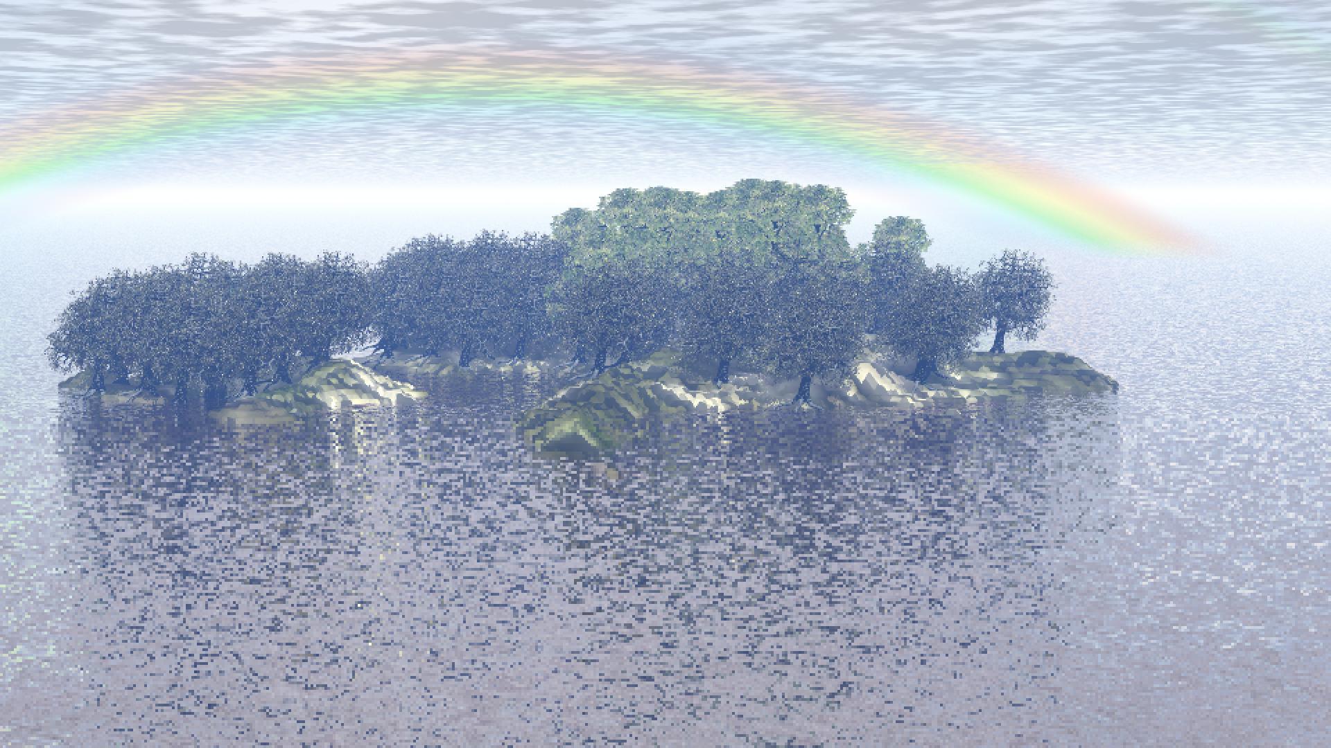

    I have induvidually added a couple trees that didn't crash it to the tree folder and rendered the instanced the result
    1920 x 1080 - 316K

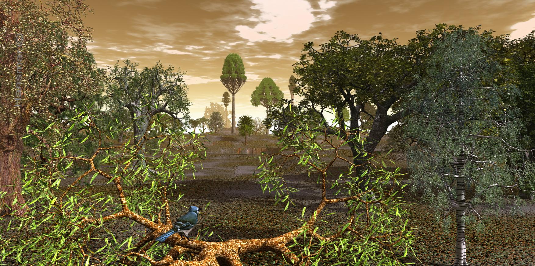

    Yeah  I got one tree to import yesterday
    1200 x 900 - 523K

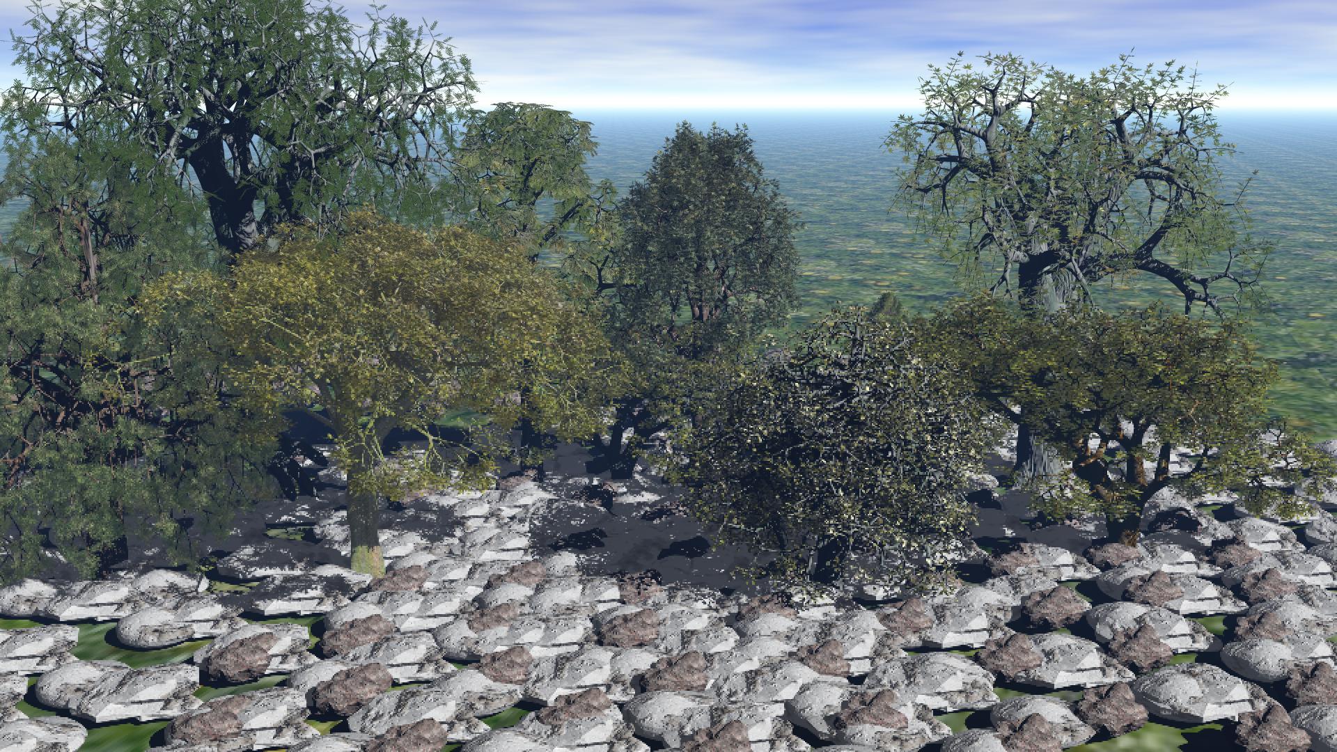

    well two Bryce renders in one day, that's unusual for me cheeky
    my terrain a bit rough though, this is the first two trees, will need to go through and save the not crashy ones enlightened
    well only the third and second to last tree from the fiirst set an issue
    a few more in the other sets
    I find wireframe a bit deceptive did not realise so many rocks blush
    1920 x 1080 - 956K
    1920 x 1080 - 517K
