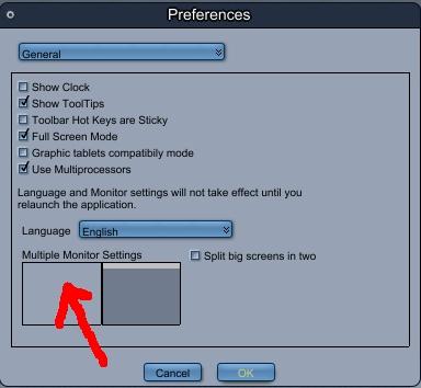

    Go to PREFERENCES and pull down to GENERAL. The multiple monitor settings are there.

    In the preferences, look under General. The option should be there unless it was moved.

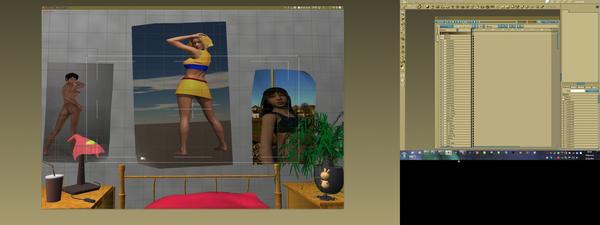

    You need to maximize Carrara by clicking on the little square icon next to the "X" used to close the app in the upper right corner of the window (not the one that Windows/Mac provides, but the one Carrara provides right below it. If you've set it up for multiple monitors in the preferences, one monitor should show the app as it is on a single screen, while the other will have the blue-gray background. At that point you can move things like the library and properties windows onto the second monitor - though it can still be a bit tricky to grab the right part of the window you want to move.
    I'd do a screenshot, but there is a bug in Carrara 8.5 that won't let you use multiple monitors when you have more than two monitors connected (I have 3 and refuse to disconnect one just for Carrara).

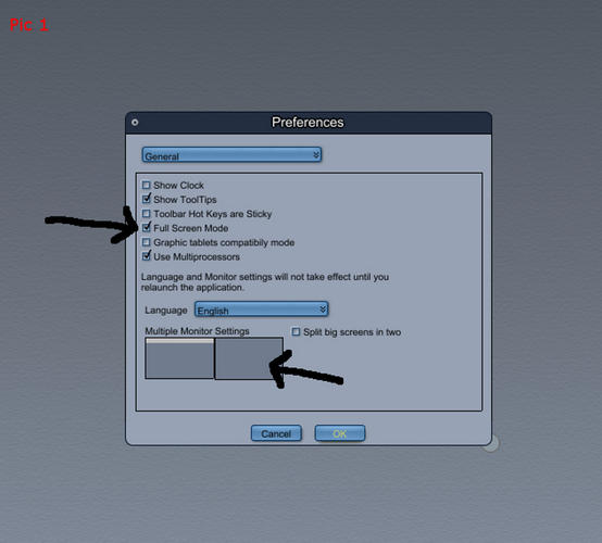

    SLoTH_XVX,
    DAMN it....Why wont this thread allow me to upload pic in the right order ??? GRRrrrr
    Carrara will work fine on dual monitors and once you've done it once you'll never go back.
    There is no problem with the application but more a little tip or two to get you up & running.
    In Pic 1 - you'll notice the 2 arrows, the lower one shows two boxes side by side with the left
    one blue'ish/ grey and the right one the same colour as the dialog box. This is how it should
    look for single screen mode. In my pic you'll see that both are blue'ish grey, this is because i
    have clicked the right one to become the same colour as the left. This effectivly enables dual
    monitor config. Ref the upper arrow, make sure this is ticked to enable full screen mode.
    At this point hit 'OK' on preferences box and close down carrara completely.
    Now restart and you will be officially in dual screen mode (pop into preferences to make sure
    both the boxes are still blue'ish grey & close prefs again). If all this has worked then you will have
    Carrara's full interface in what is known as your primary monitor (which should be your left one)
    and the whole of your other monitor should be the blank background which Carrara produces.

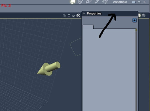

    If so far so good - See Pic 2 - See the left facing arrow at the top of the properties tray ? Click
    this with your mouse and you'll notice the properties tray un-docks to a stand alone window
    (clicking the same arrow will redock it for single screen mode again).
    Pic 3 shows the tray undocked (floating)
    Grab the floating properties tray by it's title bar at the top and slide it to the right onto your other
    screen as seen in Pic 4
    Pic 4
    NOTE: If you cant go any further to the right than the right edge of the screen then try sliding the
    properties tray off the left hand side of the screen - If this allows you to move on to your other monitor
    then Windows (if you are using windows of course) will probibly have your monitors layed out in
    reverse at the operating system level (ie screen 2 to the left and screen 1 to the right instead of
    screen 1 to the left and screen 2 to the right) This happened to me and it needs to be corrected
    through your display settings before continuing in Carrara.
    To Be Continued......

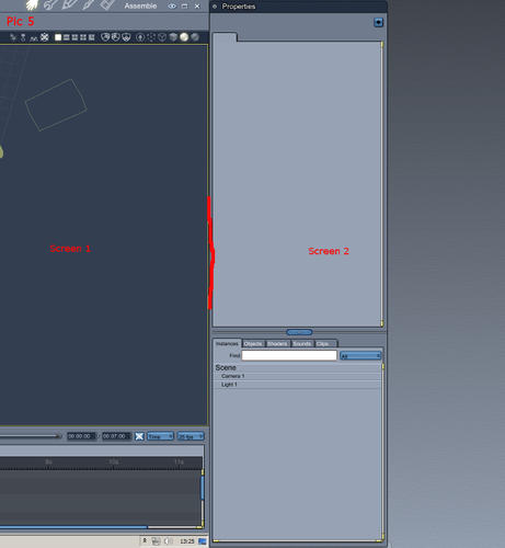

    With 'Shortcoming 2' in mind, once you have the properties tray filling up the left side of
    screen 2 from top to bottom & also touching the left hand edge of the monitor.......
    See Pic 5
    Close Carrara down & reopen again - At this point you should see that Carrara has set the
    default width for the Properties tray so now you'll be ready to deal with the sequencer tray.

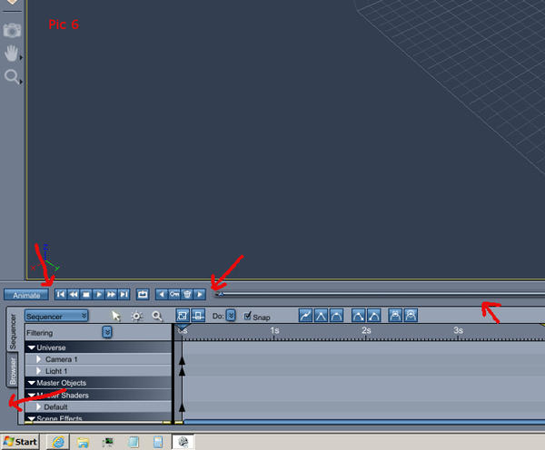

    Part 3
    The Sequencer tray has'nt got the little arrow like the properties tray (for some strange
    reason) so un-Docking it is a little different.
    See Pic 6
    In Windows, hold down the CTRL key while clicking & dragging only in the areas shown
    in the pic, so long as your not trying to click on a tab or button for example then dragging
    should cause the sequencer to Un-Dock.

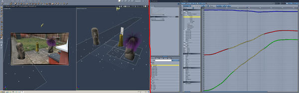

    Added a screen capture of how mine looks when running dual, the rather 'unstraight' red
    line is the divide between the 2 screens :-D

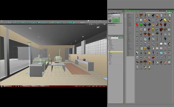

    :O wow! that's impressive.
    The sequencer list and the instances list are right next to each other... Do you find them redundant? Can you minimize the instances tab? Or do you find there are advantages to having both available?

  • EddyMI3DEddyMI3D Posts: 365
    I gave this topic another try with my new monitor setup (1280 x 1024 and 2560 x 1440).
    When I switch to Carrara's Full Screen Mode I get that what you see below.
    No background colors, nor Tool Bars, no Icons
    1920 x 720 - 95K
  • PjotterPjotter Posts: 273
    You have to drag the outside border of Carrara to both screens. Then drag the border of your working area back to your main screen. On your main screen is your working area and your other screen has the sequencer / explorer part (for me that is on the right hand side).
    Because you have different sizes of screens, a part of your large screen will not be used. You could try different screen resolutions.

  • ds-mail_2e0cb9c256ds-mail_2e0cb9c256 Posts: 70
    I've been using C on dual screens for many years. Now C8.1 on win7x64 with second screen in portrait mode; works for me.
    Doug.S
    780 x 480 - 42K

  • cdordonicdordoni Posts: 580
    Thom,
    Go to the General tab in Prefs. There's a dual monitor setting there. I believe you have to click on the panel for the second monitor (its blank by default). At least that's how it works on my Windows system.
    384 x 354 - 38K
