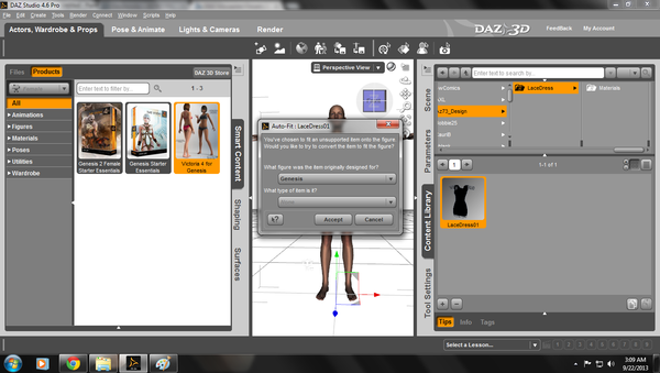

Hi, I'm having an issue while fitting clothing to G2F. The odd thing is it has worked fine up until recent, I'm not sure what happened. What is happening is, when the dialog pops up, no matter which option I choose, i.e. Genesis, Victoria 4, Victoria 4 Skirts, the second option always has none. It doesn't get in the way too much, but I have a feeling it will. I've tried using the install manager to uninstall Genesis 2 and reinstalling it, I've reinstalled Daz Studio and nothing seems to help. If anyone has any ideas, let me know. Here is a screen shot of whats going on. Note this problem is just with G2F and everything else works fine.

Hmm.. I'm a bit lost as to what you have shown here. Lacy Dress for Genesis should Auto Fit to G2F just fine. You can not fit it to V4 just becuase you have V4 for G2F. The items only work forward not backward. Are you Loading the Dress from a content folder Mapped to DS4+ ?
I used to have options, it doesn't matter what I try to put on her (as long as it isn't G2F). I was just trying on that item, it doesn't matter what I use. And yeah I have V4 to G2F. I used to get options when putting an item on that wasn't specifically for G2F, now it always says 'none' on the second box. Things usually Auto-fit fine but it might be a problem with skirts and shoes.

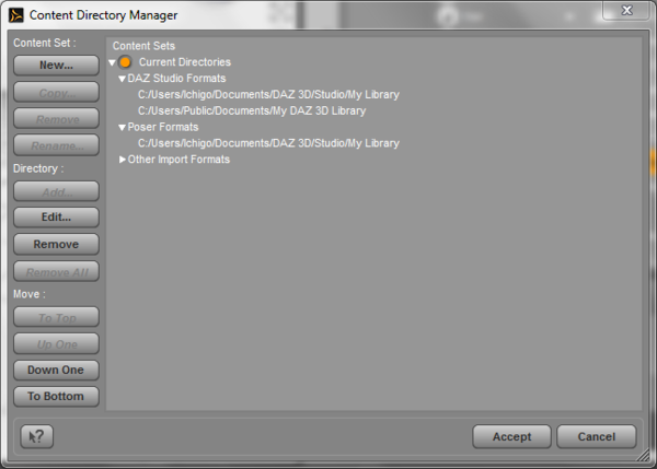

You have 'nested' library paths in Poser Format. It would be helpful if you did expand Content Directory Manager so the whole path can be seen.
Yeah I'm using DiM and here are the screen shots I think your asking for. Sorry for the low res of my screen, this is what happens when your powerful desktop is connected to a 720p TV lol.
You can NOT have a content Library inside a Content Library. That is 100% Broken.
I changed it so the poser runtime looks as it should and it still didn't fix the problem. I restarted Daz before I tried again. Any ideas?
You have NESTED content Folders. That BREAKS the content reader in DAZ Studio. You can have this...

You have Content FOLDERS inside a Content Folder. That will not work.

Sorry, that's just G2f's default setup, I'll just delete her if I don't need her. I deleted all my poser runtimes (which were somehow found by the content search) and just readded the one. That's all I have in that screen shot. And there is no My Library folder for poser formats, that's just what it calls my runtime for some reason. So I'm not sure how I don't have what you are talking about.
Here is a new screen shot of my Content Directory Manager. I've also got rid of any other folders that are named runtime and shouldn't be and it's still not working.

We need to see the Content Directory Manager expanded to show the FULL paths listed. Not the ones shown with the ends cut off.
We need to see the Library folder you are using OPENED and captured to the END of the folder list.

I've figured out the problem (kinda). I basically renamed my current library and reinstalled Daz and all of my Daz acquired content. Everything worked fine until I put my old content back. So yes, the problem is in those folders, Here are those shots you wanted.
You need to list BOTH folders as POSER format just like you listed BOTH as DAZ Studio Format. You are so close this time.
You say you are using DIM and yet in the projection template search there are a lot of "Content" folders that DIM would not have installed. At this point the easiest solution would be to delete your libraries and start over. I suggest you install all content to the Public library and use the User library for saving your personal files only.
