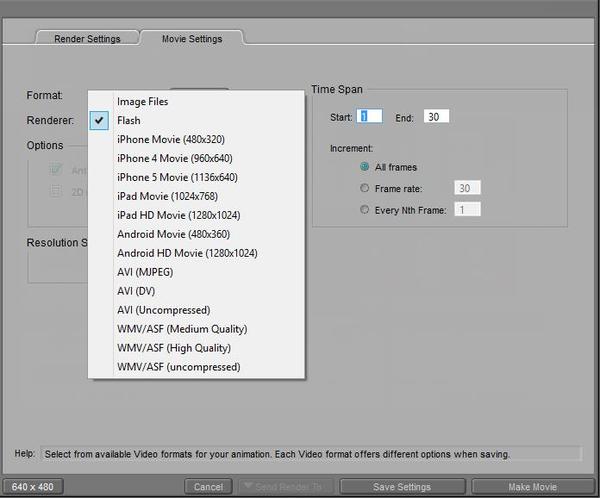

Hoping someone can help here, despite having installed extra codec packs on my computer Carrara 8.5 is still only showing animated gif, avi and sequenced images as the movie output options - as can be seen by the attached image.
Any clues on what is happening?

    What other options might you been looking for? On 64 bit windows we do not have quicktime if you were looking for that one in particular.
    Rich

    It's just that I have seen other threads where there were more options than I have displayed - I cannot find the thread now.
    So the only option is avi?
    Guess I am spoiled by the options in Poser (see below)

    Have you clicked the options button next to the dropdown menu?
    I basically have the Mac equivalent to your initial screen shot, but if I click the Options button I get a whole bunch of different codecs to choose from. They're a bit more technical sounding than the ones you posted, because what you posted was a mix of some codecs and some codec presets optimized for specific devices.
    If you're going to do any editing of your video clips, use the least compression possible and a lossless codec to avoid trans-encoding issues later.

  • TastigerTastiger Posts: 76
    No - my list is way less than that :-

  • Box8068_31c338ee4bBox8068_31c338ee4b Posts: 292
    As stated above. You're on windows. For more options you need to use the 32 bit version. I model and animate in 64 bit but render out of the 32 bit version to get more options. Also be careful, I have seen codec packs wreck computers before. Esp klite
    8068
    If you render to an image sequence, then you can use the 64 bit with no issues, then compile the image sequence in whatever video software you use. Png is a good format for image sequences as it's efficient space-wise, lossless and supports alphas. There are other ones as well that support alphas but are larger file sizes such as tiff.

    I couldn't help but to notice Lagarith Lossless Codec in your list. For some reason, I have been unsuccessful with using that in Carrara, so I am still making Full Frames avi files. I don't want loss in my raw render output. I am still not too keen on sequenced image output. Not sure why. But it drives me nuts when I go to view one of my renders and I discover that I did 'That one' in image sequence! Argh!
    If it's along complex scene I'll use an image sequence. If it's a short noting little scene, I'll render to a movie file right away. If I have issues with bumping up against my memory limits, or a mysterious crash I'll use an image sequence.
    It's a tool like any other. It only takes a few seconds to open Quicktime and compile an image sequence to a movie. Plus, the advantage for you 64 bit users, is that you can render using 64 bit if your choice of codecs or whatever is 32 bit, which may be your issue Dart.

    Thanks all - I may just install the 32 bit version and see how we go - although you have provided plenty of information to mull over.
