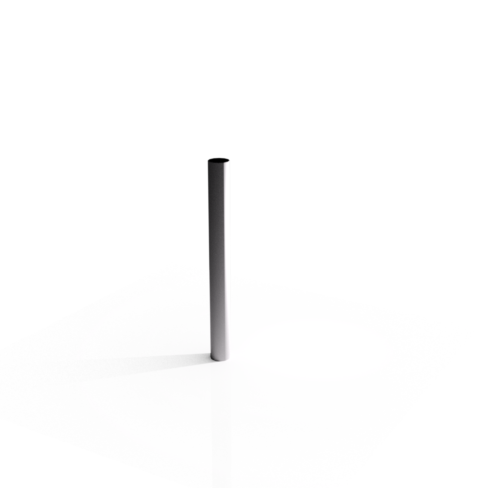

  • Richard HaseltineRichard Haseltine Posts: 111,647
    edited February 2020
    I have here a plane, with the Advanced Iray Node Proerpties applied and Enable Iray Matte on, a regular cylinder, and a point light. Enviroment Mode is Scene Only, Draw Ground is Off, Shutter speed is 32, ISO is 1600.

    I'm going to add more information, since it's vital I get shadows cast on either a ground drawn by the Environment render setting or an invisible plane.
    As you can see here, I can get a point light to cast a shadow on a normal plane:
    If I hide the plane, a shadow does not get cast on the ground drawn by the environment:
    If I use a distant light, I can get the cylinder to cast a shadow on the ground drawn by the environment:

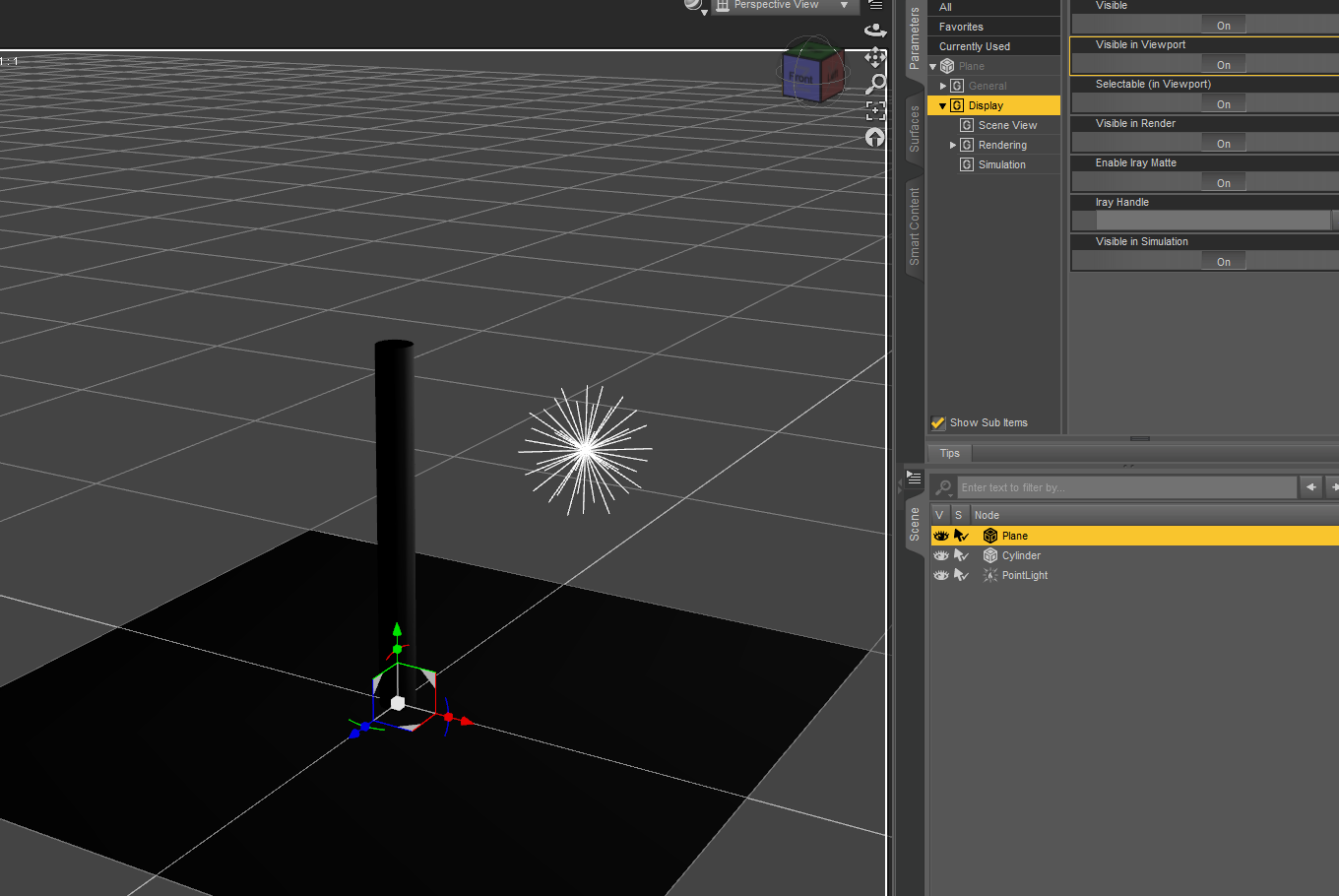

    If I apply Create Advanced Iray Node Properties from the Utilities menu to the plane, then set Enable Iray Matte to on, a shadow does not get cast on the plane when visibility is set to off:
    However, if I set it's visibility to on, it does cast a shadow....
    ... but the above defeats the purpose. I need only the shadow cast from a point light and the model to render, not the plane in anyway.
    Can anyone please help me figure out how to get a point light to cast a shadow on either the ground generated by the Environment tab or an invisible plane?

    Richard, I'm going to list exactly what I did, and perhaps you can tell me what I forgot to do?
    I create a new DAZ project.
    1. I set Environment mode to Scene Only.
    2. I create a cylinder and plane primitive.
    3. I add a point light with luminous flux set to 300,000 and position it so it casts a nice shadow.
    4. I apply Create Advanced Iray Node Properties to the plane primitive, then select the plane and set Enable Iray Matte to On.
    5. I click Render.
    6. I export both PNG and TIFF (which required two renders)
    No matter what I do, I cannot make the plane invisible. The shadow strength also diminishes severely. This has a green layer added in photoshop to show the plane is still there.
    Here is how my scene looks, the viewport is rendering IRAY:
    Here is my point light settings, I changed nothing else.:
    Environment setting, all other IRAY render settings at default:

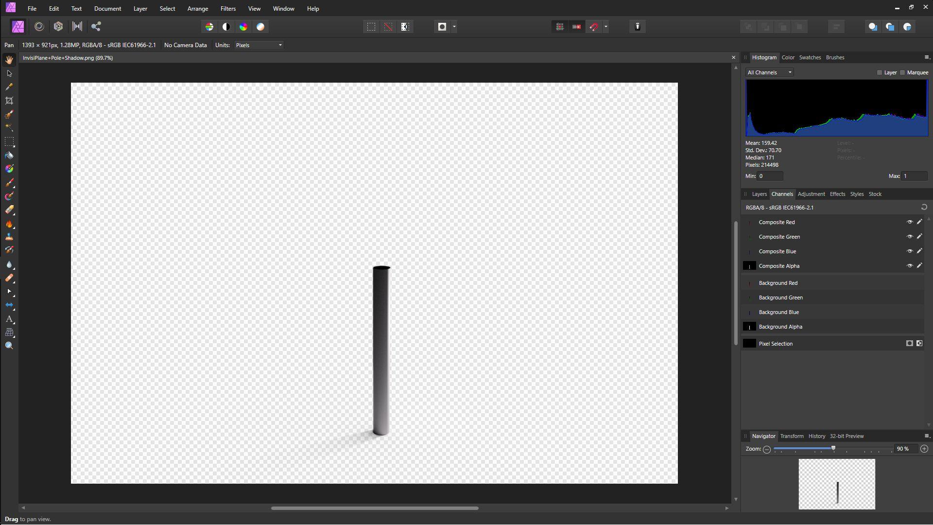

  • Doc AcmeDoc Acme Posts: 1,153
    I'm coming to this pretty late but for the record I do see the same issue as you with a Point Light + virtual ground Shadow Catcher. Switch the Point out to a Distant & tilt correctly and it works.
    But Spot doesn't either.
    So BUG. That should work for ALL lights or NONE.  And since it works for one ...
    Even so, rendering out a png from Richard's DUF, simply viewing or opening depends out what you're usivng; there still are some fuzzy areas for how some apps handle pngs.  See the attached.
    I don't have Photoshop on this system and one plug I've used for years & really miss, used specifically for PNG's is Fnord's SuperPNG.  https://www.fnordware.com/superpng/
    Snag that & see if that works better for extracting than just native Photoshop.
    Beyond that Flortale, some of your requirements go unexplained & are a bit confusing frankly.
    WHY does it HAVE to be a point light for example?  I'm assuming your wanting a perspective shadow.
    Why can't you use geometry again?  You see the edge of the plane?  Even a 1000m. plane?
    What is your actual end goal? There may be other simpler, easier ways to get there if we knew what that actually was. It really isn't Rocket Surgery.
    1920 x 1080 - 298K
    1920 x 1080 - 60K
    1920 x 1080 - 24K

    I'm down for using geometry to light the scene. I eventually planned to try Ghost Lights, and I think those are geometry based right?
    In this image, you managed to catch the shadow. Did you use a geometry light for this scene? These results are totally acceptable.
    Is anything lost when using geometry lighting vs point light? Thank you for taking the time btw, same to Richard.
