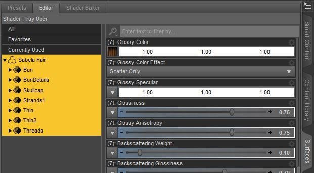

You should be able to select all the hair in just one click. Just open the surfaces tab and click on the name of the hair -that should select all the surfaces:
thanks..yes..i actually looked at what popped up when using the surfaces tab...i tried a layer on it though, and that did not work. will play aorund a bit.

1. Apply Base Color
2. Apply a Mask from the "Masks" layer
3. Apply a color from the "Overlay Colors" folder
I'm pretty sure those are the steps. I can't check right now but as soon as I can I'll double check to make sure those are the steps. :)
By the way, what hair are you trying to work with here? If I have the hair you're using I'll take a look to see if there is something different that might be interfering with the way the shaders are applying.
2. Go to the Surfaces Tab and select the hair there too.
3. Go to the product in your library (Shader Presets >> SloshWerks >> ColorWerks).
4. Go to the "Base Colors" folder and select a base color.
5. Go to the "Masks" folder and select a Mask.
6. Go to the "Overlay Colors" and select an overlay color.
I did a quick render with an orange on blue color scheme like you mentioned earlier (I don't have the Apple Hair but this is another hair by the same PA).
I used:
Base Colors >> Fantasy Colors >> Blue 018
Masks >> Blend Masks 18
Overlay Colors >> Fantasy Colors >> Orange 018
wow..thanks for going through all that .. it is the mask part that i missed ..or didn't know about. Do you have to do similar to apply thw shine? and then there is something about tiles ...

1. Select the hair object in the scene tab
2. Select the hair surfaces you want to apply ColorWerks to in the Surfaces Tab (you can select more than one by holding Ctrl as you click each one).
3. Apply a Base Color from the ColorWerks (CW) base color folder. At this stage, you are done with a basic color.
4. To blend another color over the hair, you apply an Overlay Color from the appropriate folder, as well as a Mask from the Mask folder. It does not matter what order you do this in. You will likely not see the effect very well until you test render or use the Nvidia preview mode in your viewport.
5. To use the scalp color feature, choose the scalp in your Surfaces Tab. Apply any base color from The Base Color folder.
6. With the scalp still selected, go to the Utilites folder and double click the Scalp Color preset. It will not look any different in the viewport, but when rendered it will have colored the scalp the desired color.
I hope this helps answer some of the questions. I apologize for not taking the time to write a pdf guide. I am guilty of forgetting that everyone does not use Studio as much as I do.
