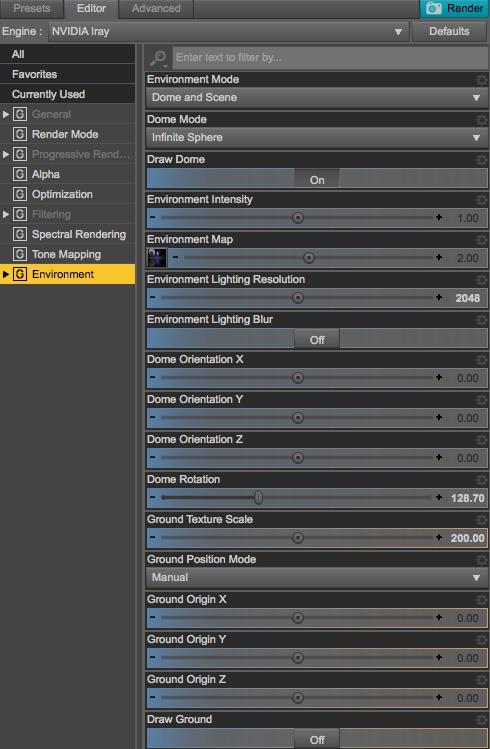

    The quick answer is on the Render editor tab, there are controls to rotate, tilt, raise and lower the HDRI "dome" so that you can choose the direction of the light.  The ground setting at the bottom has two settings, manual which makes the characters feet fett rest niscely on the ground, or auto which has the haracter float a little above.  You can also turn off the HDRI so that you just get the effect the light and use a background in the render environment tab.
