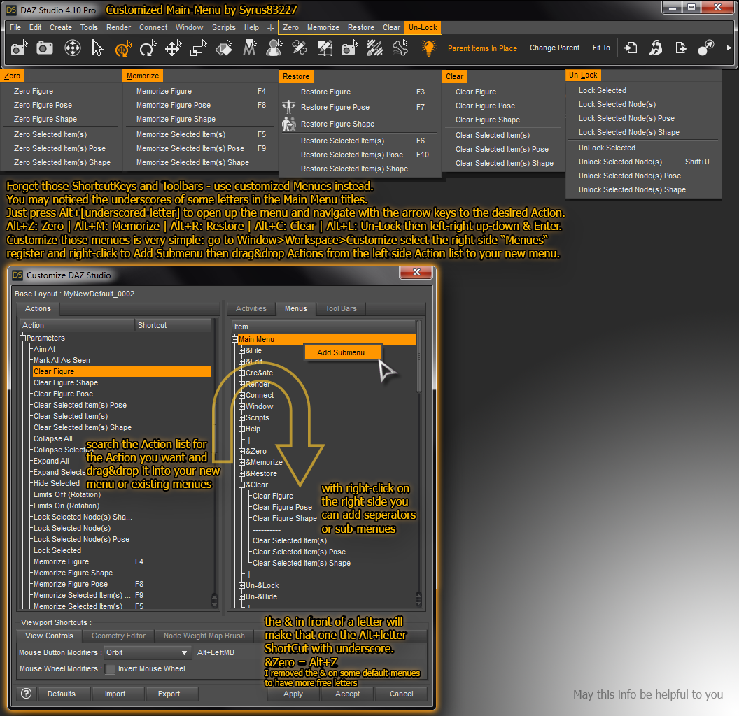

    Its faster to acces those Memorize/Clear... commands from the Parameters pane Options Menu (the little button with those lines and a triangle). Its even faster to assign a keyboard shortcut to those commands like I did on the F2 to F8 keys with the Window>Customize dialogue.
    See my thread about changing keyboard shortcuts here:
    How to Customize Daz Studio - to speed up Workflow!? [WIP]
    Especialy the custom Menus can help if you don't like to use or can't remember additional keyboard shortcuts.
