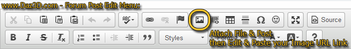

If you came here and just ask yourself how to add highres images in this forum - I'm also using PNG files with lossless compression for more details.
Daz3D_ForumPost_EditMenu_1.png 703 x 100 - 66K

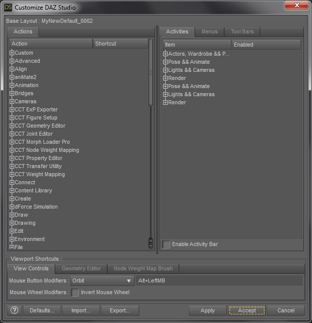

    changing Mouse Button Modifiers
    to Navigate more easily in the 3D Space while your MouseCusor stays over the Viewport:
    for Perspective View changes and for to positioning the Camera
    Quote from Animation Tools
    The 3D Scene navigation in the preview window is the most important part while working with 3D content and used all the time. I always scratch my head if I see people in tutorial videos using the view controls on the right upper corner beside the Cube to change the perspective. How time consuming and tedious. Sometimes I think its just theier inablility to work with both hands the same time. If you are used to First Person Shooter Navigation WASD (Edit: customized not default Shift+K to activate) you can use that but for me its more anoing than helpful.
    Before I even get used to work with DazStudio I got my 3D navigation setup like I'm used to with other 3D programs (in ZBrush everything to change 3D perspective works with the Alt key and I managed to teach Blender to do the same - now I can switch my work with the programs without even thinking of how to navigate the view).
    To change keyboard shortcuts you can go to Main Menu: Window>Workspace>Customize
    In the bottom section of the dialogue you can see the Viewport Shortcuts: View Controls
    I think by default the Mouse Button Modifier for Orbit is set to Ctrl+Alt+LeftMouse but I want it to be Alt+LeftMouse like I''m used to in other Programs eg. ZBrush.
    I have changed most of the Mouse Button Modifiers there to work with only holding down Alt+[someMouseButton].
    But you will be warned that some of the key+mouse combinations I use are allready mapped to something else to control in the Geomerty Editor or the WeightMap Brush - but I dont miss them - I'm so used to press the Alt key while my mouse is over the viewport (after a few years now the Alt key even lost its labelwink).
    The most time I use:
    • Frame Selection: Ctrl+F (If we orbit we need a fixed point to orbit around - can be found in Actions: View Control then right-click Change Keyboard Shortcut - also WASD navigation can be found here)
    • Orbit: Alt+LeftMouseButton
    • Pan: Alt+RightMouseButton
    • Zoom: Alt+MiddleMouse+MoveMouseUp-Down (let you zoom stepless to get as close as possible to tiny parts - but then even with the Perspectiv View (camera) you get some clipping - eg. you zoom in on someting and then you see throug elements that are close to the camera - the "clipping" value is not that good - could be set better)
    So while my right hand is on the mouse - my left hand stays over the keyboard with the thumb over the Alt key. I can also reach every KeyCombination even eg. Ctrl+O or Shift+L with the left hand.

    Sorry I usualy explain things more complicated than they are. So I made a new screenshot with instructions for everyone to show how to change the Mouse Button Modifiers in the Customize Settings @ Main Menu: Window>Workspace>Customize.
    [PS] I know this is a bit complicated but once you setup your Mouse Button Modifiers and keyboard shortcuts as it makes sens to you, you will get used to it by the time and never think of it again. For the beginning it can help to make a note of all the shortcuts on a piece of paper and post it next to your monitor.
    BTW even if you change these Mouse Button Modifiers the mousewheel scroll zoom will still be available

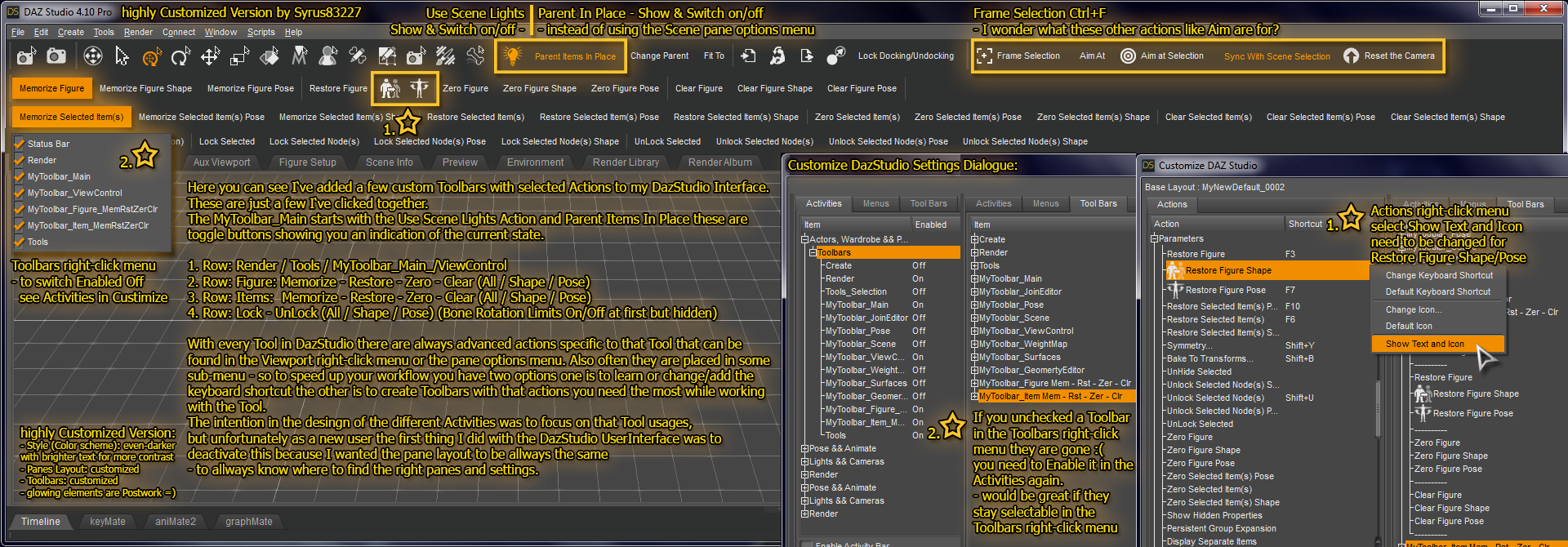

    custom Toolbars
    I've been bussy on that Customize DazStudio Settings.
    Now for to find a solution for everyone who cant remember all the KeyBoardShortCuts. Another way to deal with all these Action commands is to create custom Toolbars.
    There are allot of Actions if you want to have all on screen for Figures / Items: Memorize - Restore - Zero - Clear (All / Shape / Pose).
    I wonder if someone ever written a script for allways trigger both coresponding Actions for Figures / Items with one command?
    I mean I can choose what to select in the scene pane and if I make multible selections of Figures / Items - why do I allways have to take care of using both Actions for Figures / Items?
    I've also added the Lock-UnLock toolbar with all related Actions on that.
    See my screenshot for what is possible (its almost HD this time 1920x670 to show all the Toolbars)
    While doing this I've discovered some good and some bad things.
    The good things are the Actions that can be toggled on/off like "Scene Lights" and most important "Parent Items In Place" (Parent In Place would also been enougth sayed because it works on Figures too).
    The bad thing is that you can choose what Toolbars not to show with the right-click menu on them but then they are gone and no longer selectable in this menu - you have to "Enable" them in the Customize dialouge Activities section again.sad- it would be realy great if they stay selectable even if Enabled is off for this Activity Layout - to show only the toolbars you need for the moment.
    Workaround: use the Activities feature with customized Window Pane Layouts & Toolbars for different tasks with the various Tools in DazStudio.
    What do you think? If you like I can attach the Workspace Layout / Toolbars / Style / Actions .dsx config files.
    This image has been resized to fit in the page. Click to enlarge.
    Post edited by Syrus_Dante on

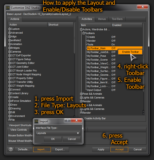

    Downloading and using the provided config files
    As you can see I have attached a few ZIP files.
    Dont ask me where to put those files. To use them extract them somewhere you can find - then go to DS main-menu: Window>Workspace>Customize - press the Import button on the bottom and choose what to import Menues / Toolbars then select the right .dsx file in respect of the previous selection. I give no warranty of any kind that it will work or that DazStudio will work as expected after importing the config files.
    You can't import the Style so you have to put the file into this folder (Windows specific) "C:\Users\[User Name]\AppData\Roaming\DAZ 3D\Studio4\user styles" to select it in DS-Main-Menu: Window>Style>Select Style.

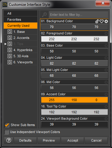

    custom Style
    As you can see on my previous screenshots I'm using a very dark Interface color Style.
    This is just easier for the eyes to look at for hours while working with DazStudio and also will give you the impression of working with a professional program like Photoshop or ZBrush.wink
    In the screenshot you can see what colors I've changed. I also brightened up the "02. Forground Color" that is for the text color and it will improve readability and contrast to the dark backround colors.

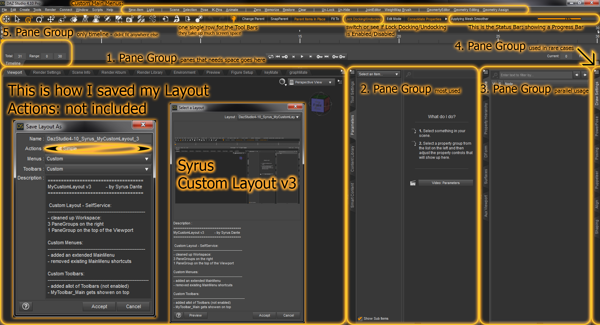

    My suggestion for the Workspace / Panes Layout
    Quote from PANE REARRANGEMENT INTERFACE SUGGESTION
    [PS] I thought this would be fit in here as well.
    Hi,
    yea I was thinking of this issue for a while now - the interface of a program is very important to work with it efficiently.
    Foreword
    I remember as I once started DazStudio for the first time - maybe it was version 4.5 and I saw the default interface layout I was wondering what all the toolbar icons are for and thought of - damn will I ever know what every single symbol stands for? Today I'm wiser and know most of it I will never use or there is some other way to reach and use this function.
    After a while I realised that you can customize the interface - so the first thing I did was to switch the layout to "self service". What this exactly means - I found out just recently.
    For the beginning I recomend you to clean up the interface and just concentrate on the most commonly used panes: Viewport - Parameters - Scene - Content Library - maybe Smart Content. Every other pane can be opened as needed with going to Main-Menu: Window>Panes (Tabs) and every Action / Function that the default Toolbars provide can also be found in the Main-Menu or the panes options sub-menus.
    the Red Dot
    Oh you thinking of a RED DOT - maybe you can win the Red Dot design award with that.wink Sorry for this joke I couldnt resist on that wordplay.
    I know what you mean and I've seen this concept of maybe a dotted outline or an empty space to show you the areas where you can drag&drop Interface elements in edit interface mode in other programs. But in DazStudio you can work with the program regardless of - if the "Lock Docking/Undocking" in Enabeld or not - this is an advantage I think. If you drag panes around you should see a highlight line in the area you drag the pane over to create a new Pane Group.
    As an alternative you can see that I have included the "Lock Docking/Undocking" Action in my Toolbar (called MyToolbar_Main). With this I can allways see the status and switch it to Enabled/Disabled.
    This affects the ability of all panes at once to get draged&droped somewhere else in the interface. I think this is easier to understand than to have to switch the draging&docking ability for every single pane seperate.
    As you can see in my screenshot below I have 5 Pane Groups - maybe the Pane Group Nr. 4 is obsolete. But the concept behind this is that I am right handed so my Pane Groups are all on the right side. I wouldnt suggest you to have one Pane Group on the left and one on the right of the Viewport because then you have to move the mouse constantly from the left to the right and you have to remember - is the setting I'm searching for on the left or the right side.

    One other issue that I had and now its back is the placement of the Timeline pane. Hard enougth to understand how to dock a floating Pane or Pane Group back into the interface but if I try to dock the timline back to the bottom of the screen lately it gives me some trouble - like the timeline only docks in the bottom area of the Viewport Pane Group and I am no longer able to hide / retract it with left-click on the Pane title.
    Also other people got issues with the timline docking at the bottom see this thread: How to dock the timeline at the bottom ?
    Issues with the Pane Groups Scaling
    While talking about panes - there is a main issue with that every pane needs a minimum of space to show its content - because it can not shrink further. But this will also affect the minimum space that is needed for all other panes in the same Pane Group.nocrying
    This is why I no longer dock the Animation Plugins KeyMate & GraphMate in the same Pane Group like the Timeline. I mean its still big and there and it is awfull how much screen space gets wasted over and under the frames selection stripe - but with the plugins docked together it takes allmost one half of the screen. (Edit: I found a glitch to make it smaler in height - just set it to show in minimalistic mode go to Options Menu and uncheck Advanced View. Then resize it and check Advanced View again it stays in the height it was before with still all advanced inferface elements showing)
    While this idea with the minimum space isnt that bad - you can get problems if you try to Dock such panes that need much space by default eg. the Shader Mixer in the same Group like the Viewport - eg. see this Thread Cut Off Viewport
    Using my provided Layout
    Download my Layout and do whatever it takes with it until it serves your needs.
    This is including: Workspace / Panes Layout | The extended Main Menu | Various Tool Bars | Interface Color Style
    1. To be save first make a BACKUP of your current Workspace Layout! Therefore go to Main-Menu: Window>Workspace>Save Layout As. Then enter a name and leave all other selections Actions, Menus and Toolbars at Custom. Next press Accept - Done. You can use "Select Layout" later and change back to the pevious state if anything goes wrong or you dont like my Layout.
    2. To use my Layout you have to extract the content of the provided ZIP-File "DazStudio4-10_Syrus_MyCustomLayout_3" somewhere you can find.
    3. Then open DazStudio and go to Main-Menu: Window>Workspace>Customize. Next press the Import Button - select the Interface File Type: Layouts and press OK.
    4. Navigate to the location where you have extracted the content of the provided ZIP-File and select the file in the folder:
    ...\user layouts\DazStudio4-10_Syrus_MyCustomLayout_3.dsa
    With this Layout I didnt provide any custom Actions this stands for Keyboard Shortcuts I think - so your Shourtcuts stays the same. Also the Interface Color Style dosnt get loaded with that - and I dont exactly know how to include it within this layout file because you cant import a Style.
    But it is included with the ZIP-File in the folder "user styles" and called "Even-Darker_v4.dsa" you just have to copy it to the special folder
    (Windows specific path) "C:\Users\[User Name]\AppData\Roaming\DAZ 3D\Studio4\user styles" to select it in DS-Main-Menu: Window>Style>Select Style.
    Download Link: DazStudio4-10_Syrus_MyCustomLayout_3.zip

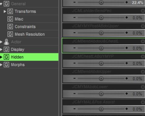

    Just found this helpful thread and, while I am familiar with a lot of it, there is something I've been trying to figure out but I can't, nor can I see it mentioned here so I'll ask.
    How do I change the colour of the Hidden Parameter label text. The normal paramters use the foreground colour which I can change but I can't find a setting for the "greyed-out" text and I would particularly like to see what those hidden parameters do but can't read the labels.
    It uses the "mid color".
    Don't know of a way to set the particular color selection on an individual basis though.
    Might be a bit more "under the hood" then us poor users have access to.
  • marblemarble Posts: 7,500
    DrunkMonkeyProductions said:
    Yep I tried mid-colour and all the others too. Nothing changes that particular shade.
