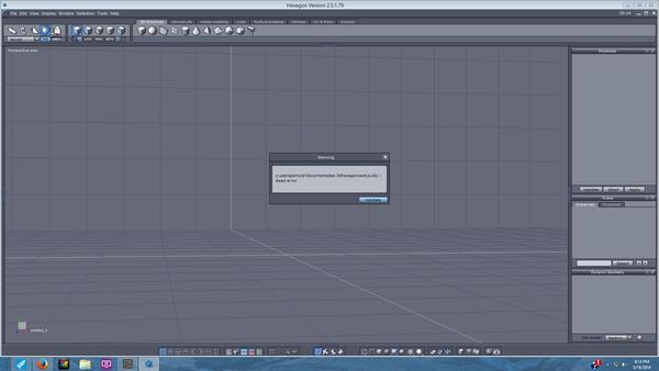

    I have Win8 that I got almost a year ago, I have just put Hex 2.5 on it again. It runs ok, but old Hex and OBJ files that I have created will NOT show up in Hex on Win8. They are invisible and I cannot figure out how to get them to show up. Any suggestions?
  • ClaywomanClaywoman Posts: 31
    This is what I get when I try to open a model that I have created

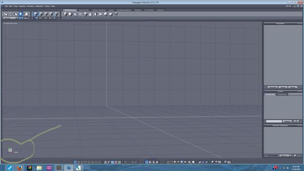

    This is the error message I get when I try to save a newly created obj. the hex file saved, but it is not in my documents. I am not sure where it is
