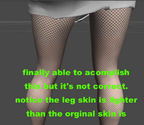

    Ok Guys i'm back. I got something near what i need but not exactly.
    This is what i did
    1. i took a completely white image ( i dont know why but i tried a black one and so i wanted to try a black too)
    and the Texture map for the stockings(tr image) and in GIMP, i put a mask and copied the Stocking texture Transparetn(black white) image to the mask. alpha channel.
    i dont even know if this was even make sense.
    2. now in unity in the stockings, i set the thighs and shins to be TRANPARENT/DIFFUSE mode.
    ANd apply the created texture.
    then all i have to do is set the MAIN COLOR of those two to R G B all 255 255 255
    and Play with the alpha. I notice if i increase it from 0 to 255.. like at mid level i do get the stockings....
    in somewhat ok,
    BUT i notice that as i'm incrreasing the Alpha , the leg color/texture in my characters skin is also changint towards gray/white..
    i dont want that.
    That means it's not correct.
    here are some pics

  • nokoteb99nokoteb99 Posts: 943
    Guys i'm back with success!!!
    I had to figure out what i was doing wrong.
    I'm sure some of you may be doing games and stuff also like With Unity so, i'll just explain my process that worked perfectly. There was a tutorial already and i did it but i wasn't getting results because there was one last sentenced that said "Optionally do this" and i didn't do it .. But today i discovered that i actually had to do that last step and now the stockings work perfectly and it's transparent.
    1. To make a composed Transparent map in GIMP... Just create a Pure black image and then on top of that add a mask and in the mask insert the original TRANS map.
    then you go to Layer/Mask/Apply Mask...and save as PNG .
    that's it.
    now in the Unity material thing for the Stockings object set the legs and shins to Transparency/Diffuse
    and add your image to both of those.. That's it!
    Make sure the Color for each of those has ALPHA 255
    **I'm sure this was probably a no brainer for some of you, but
    to me it was very difficult i spent like 3 days trying to figure it out
