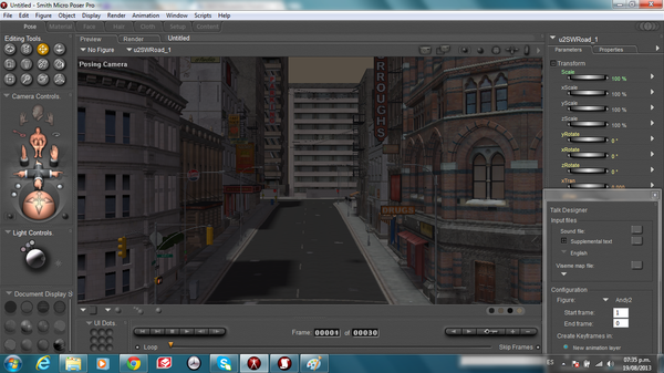

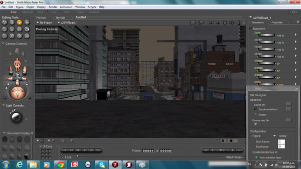

Why every I apart the camera on the urbanspwal2 the building seems to disapear? I thought it was the skydome, but I got invisible and it keeps same. I hope someone or stonemason can help me. Thanks!

    Here are the screenshots, if I move away the camera, the buildings start to dissappear. I don't know if I'm using Uber lighting, could you explain me better?

  • Design Anvil - Razor42Design Anvil - Razor42 Posts: 1,250
    Jaderail said:
    It is very easy to find your camera inside a building in some of the sets. Just dolly your camera forward a bit and see if that is it. That would be Wheel back for a wheel mouse or magnifying glass and mouse back using the viewport icons.
    I'd say this is your problem here. if you look at the second image you can see window frames in the view. You may need to delete/hide the building if you need that particular view.
    I'm not sure why it appears like an object encroaching in the distance but I suspect this is whats causing the issue.

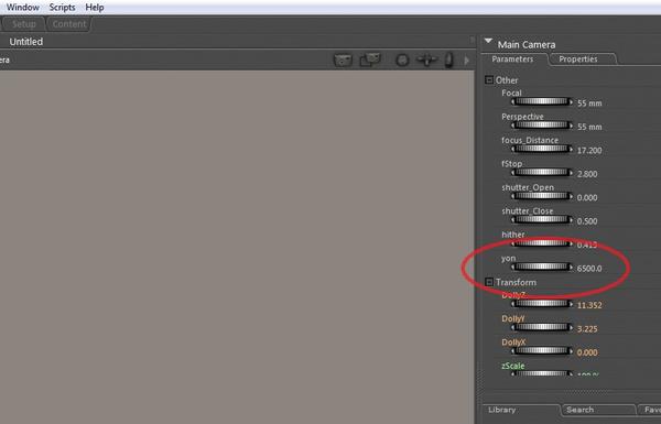

  • FirstBastionFirstBastion Posts: 8,062
    Select the Main Camera and increase your yon value to a higher number. The default value works for portraits but big scene need to increase the farclip.,

  • faisanfaisan Posts: 600
    Hey! it worked! Thank you so much! :D
