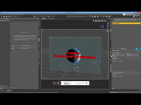

    Here is a link to the youtube video on what I do.
