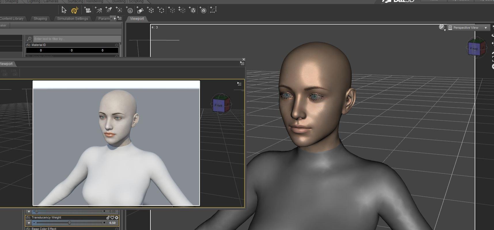

    Thank you, and no problem. I do have the outfit, though not the character, so I can guide you through the steps if you want.

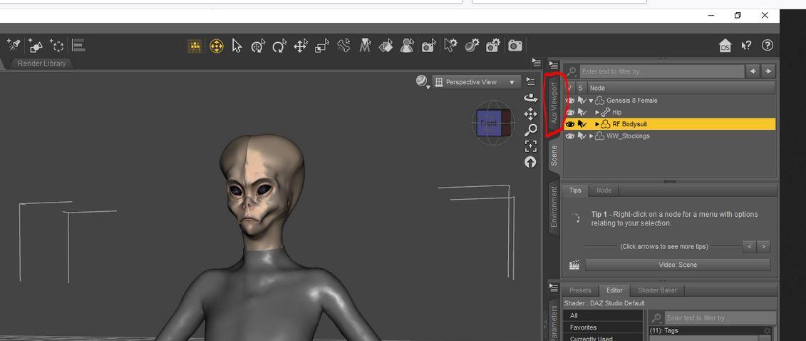

    Human skin is always tricky, but it's doable to get it to be more gray... and that suit is older - for Genesis 2 and is in 3Delight. The "white" you are experiencing in due to the surfaces being set up for a different render engine. If you send a 3DL surface into Iray, DAZ Studio does an "on the fly" conversion, but that doesn't always give the proper results, so it's best to convert the surface to Iray using Iray Uber shader, and start manipulating the surface to your heart's content from there.
    From the looks of it, you have just loaded the suit, and not applied any of the texture that comes with it, so I take it that you don't want the texture in general, just the shape of the suit with colour?
    If you select the suit's texture in the surface tab, does it look like in my screen capture?
    EDIT: Okay... for the skin surface, select the G8F figure, and in the surface tab, the "skin&lips&nails" unless you want to keep the lips in red, and the nail colour unchanged, like in my screenshot. I have marked the slots where you have to change the colour. With the changes I made there, I managed to get the G8F regular skin to look like in the iray preview render.
    If you tinker around with these three values, you should be able to get pretty close to your intended colour (unless the skin's dual lobe).
    EDIT: For the suit texture conversion, here's a short tutorial I made about converting 3DL clothes to Iray - in that case it was about a specific garment, but the general steps are the same. I maybe will help you? https://www.daz3d.com/forums/discussion/comment/3029641/#Comment_3029641
    1579 x 855 - 153K
    1776 x 848 - 135K
    Post edited by BeeMKay on

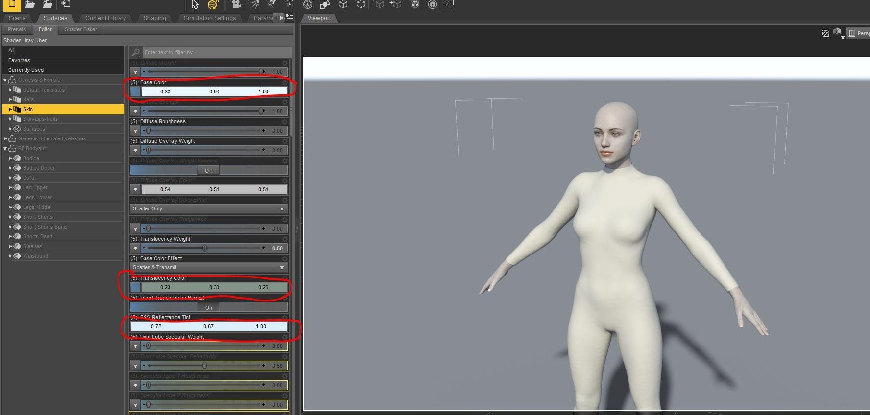

    Here are two images of my Grey.  The first is of the skin settings, the second is the outfit setting.  I got the outfit roughly the color I want it, only I prefer it not to be too shiny.  But I can't get the skin anywhere close to the color of the outfit.  Something is set that keeps it brownish.  Any ideas?

    First of all, PLEASE convert the suit texture to Iray. It is still in 3Delight, and that will not work properly. Select the bodysuit in the scene tab, then select all the surfaces of the body suit in the surface tab. Apply the Iray Uber Shader.
    Once you have converted it, look for glossy reflectivity and glossy roughness. Glossy reglectivity should be down around 40%, roughness up to 50% - experiment until you have a proper "rough" feeling to your suit.
    As for the skin - the character seems to be a morph without its own skin. May I ask what skin you are using?
    Also, the surface colour in the "standard" view can't be used for determining how the render colour will look, because the standard view uses a differenrrt render engine to display things, and it doesn't translate the Iray values properly. So, it is recommended that you use the nVidea preview (AUX Viewport) mode when you change the coulours.

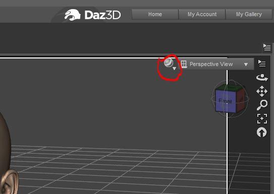

    Go to Window-->Panes, and select Aux Viewport. Though I think in your layout, it is in the top right corner.
    It might open very small. in the aux viewport you can select the nVidea preview (see below) in the upper right corner of that window. Default is "texture" mode. You can use the dropdown window left of the view selection to see all available preview modes.
    Or, if you want to use the nVidea preview inside the viewport itself. The ball symbol is texture mode. For Iray, select the Iray option from the list that will show up once you have clicked on the triangle next to the ball symbol. Oh, and you would want to stop the iray preview mode if you are loading things into the scene, do simulation, or start a render.

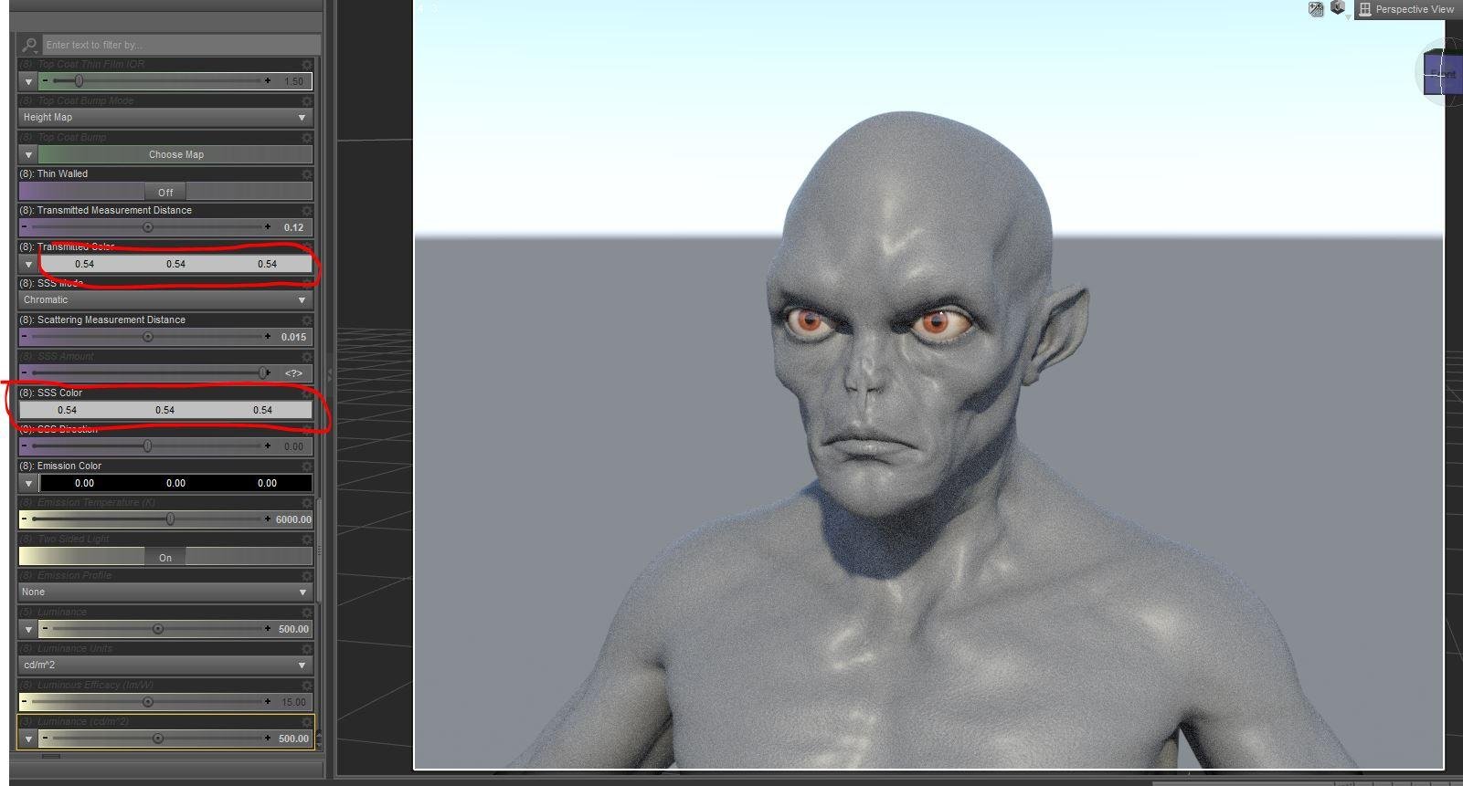

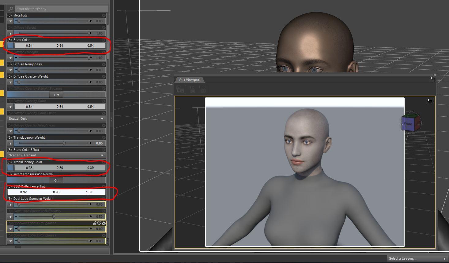

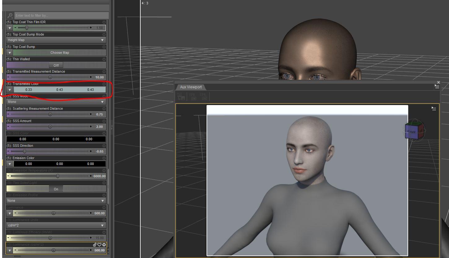

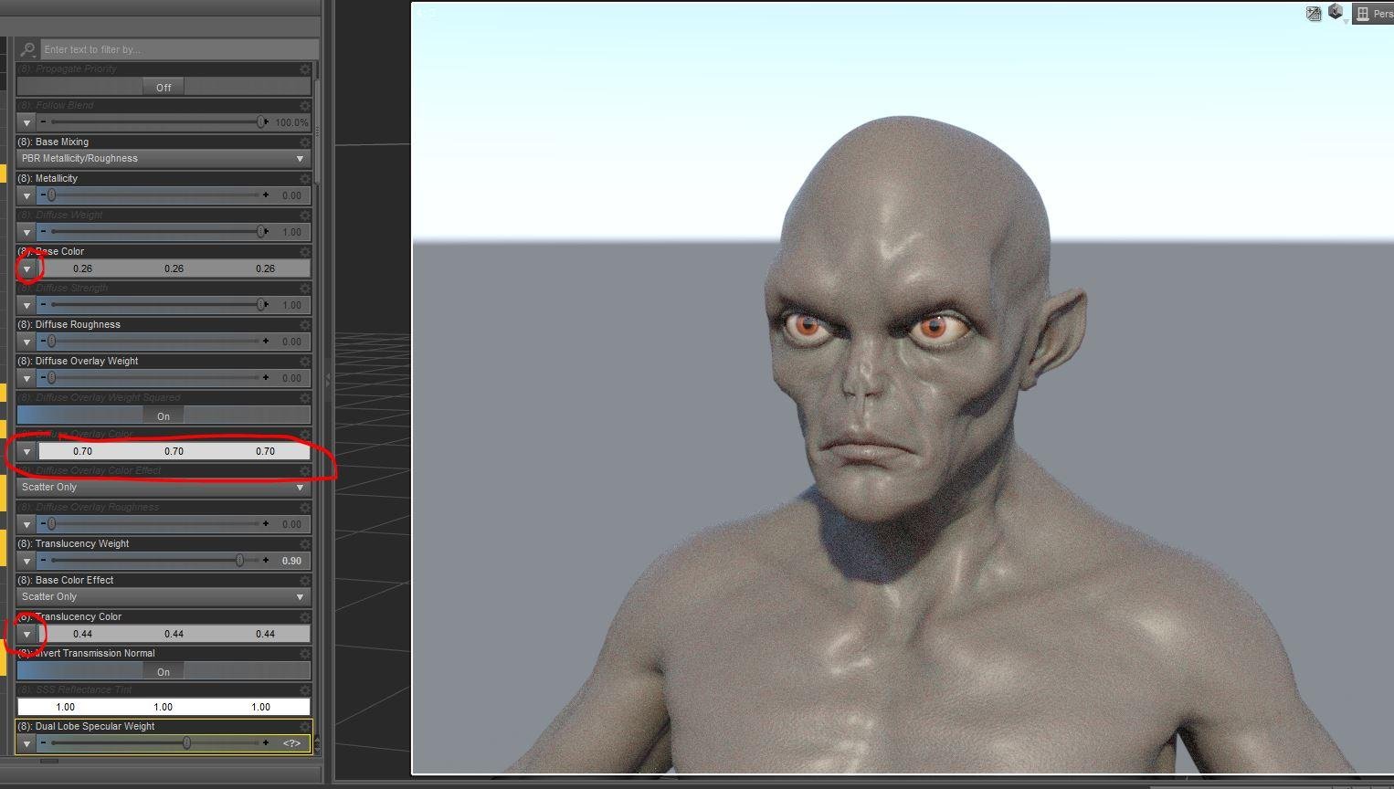

    About the skin... as you are using a G8M regular skin (the defaul skin, I presume?), which should be pretty much the same as the G8F skin, here's a setting that would give it a very grey basic colour. Translucency and base colour combined have the biggest effect on your final colour.
    543 x 385 - 28K
    1715 x 800 - 118K
    1466 x 861 - 150K
    1450 x 835 - 132K
    1131 x 478 - 55K

    EDIT: Okay... You seem to have used Michael8 skin? That behaves very differently from G8M default skin... It really is important that you state such details, because it is not possible to properly help - because there's just too many different things.
    The solution is to remove the maps in base and translucency. Just click on the square, and from the list that pops up, select "none". Then, chose a grey-ish colour. You then have to change the transmitted colour and the SSS colour. The result will be a grey skin.
    1526 x 864 - 146K
    1601 x 861 - 145K
