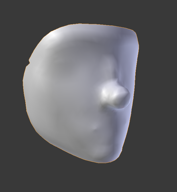

So I figured I would make as simple an example as possible to try to figure out what is wrong. I exported just the default no face from RawArt and using the sculpting tool in my modeling software, just added a large nose like protrusion:

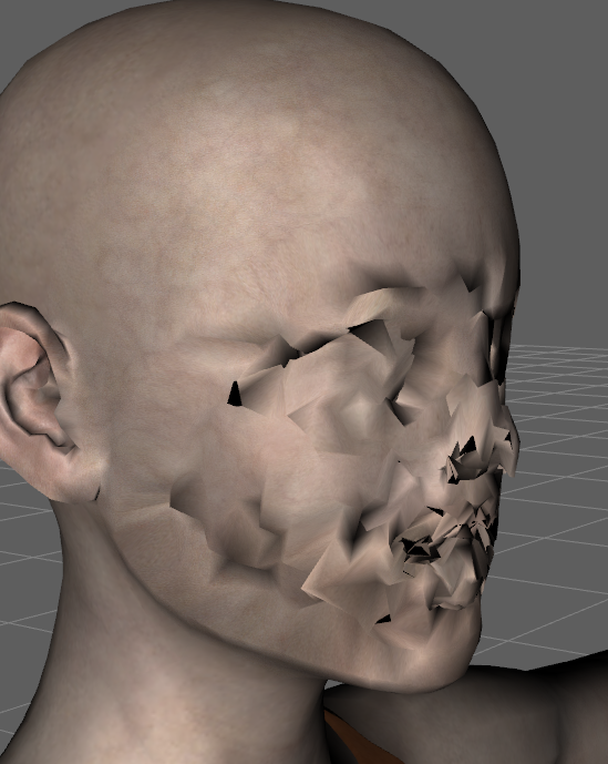

In DS, I highlight just the No_Face-G3F graft object using Morph Loader Pro, load my .obj with the above morph. Then when I try to adjust the morph the verticies all go in a direction that doesn't even look like what I loaded:
Any insight as to what might be causing this?
Could you post your options in Morph Loader Pro too, please.
After giving it (quite) a few more goes, I figured out that the problem was that I was creating a morph for my graft before I was converting it into a figure. It appears that converting it into a figure cahnges the vertex order, which was messing up my morphs. Thanks to SickleYield and mlominy for their discussion here: https://www.daz3d.com/forums/discussion/270901/where-did-it-go-wrong-in-blender-or-daz#latest
