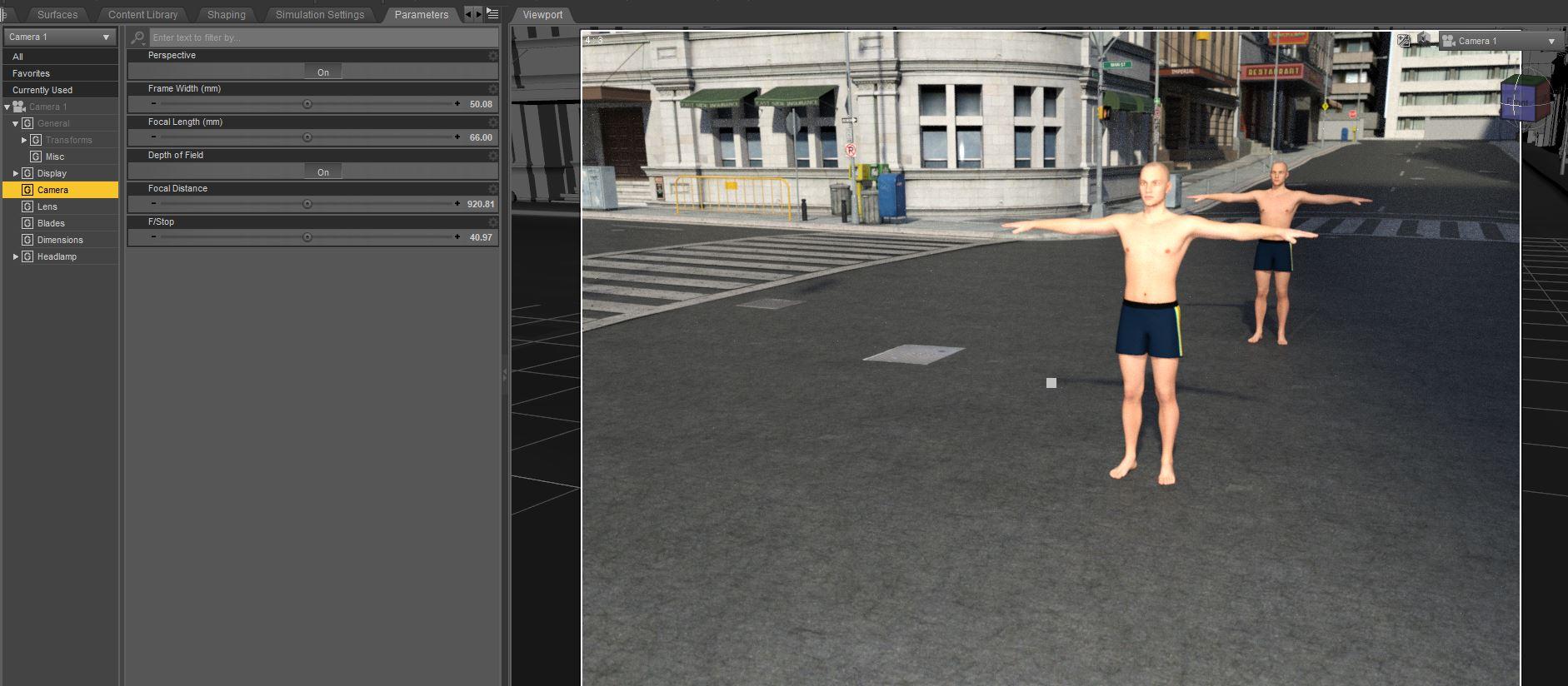

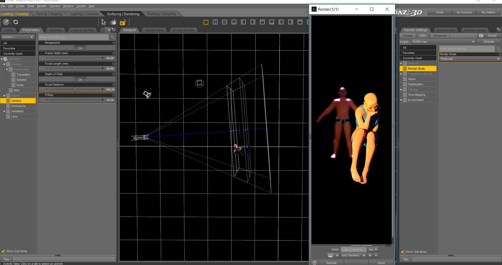

Hi my name is ... and DOF is killing me.
So this is one of those questions that you're certain there's a simple answer that has inexplicably eluded you for the last week despite countless hours of searching Google, watching YouTube vids, and endless tinkering, I’m at a loss and alas, a newb.
DOF is simply not working. I have it toggled on in the camera parameters and the other place there’s a toggle for it. I’ve diddled with F-Stop, focal distance, and slid just about every slider there is to slide. I’m no stranger to cameras, both still and motion, but all that knowledge combined with all my brand spankin new Daz knowledge has only managed to get me here. I’ll add that it was working when I first started playing around but now, nothin. Can’t get any blur or separation whatsoever. I feel like there’s a master switch somewhere that overrides the settings I’m trying to use, perhaps similar to video editing software that has a toggle for FX so you can edit at a higher framerate when working with them.
I’m not opposed to re-trying or re-checking anything anyone might suggest despite feeling like I’ve tried everything at least five times. I’m at an impasse and a wee bit desperate at this point, a whole lot more I want to do with it but seems a bit pointless as DOF to me is kind of a must-have in making anything that feels real or organic. Beggin, help!!!

    Yup, and only have one to simplify things. I can look at it in perspective view and all the markers/planes whatever the term is all seem spot on yet … no blur, zero, zilch, nuttin. And I am in Iray if that’s the next =P

    Humour me again... can you please set up a scene like this:
    (The only way I found to "ignore" DOF was when "Perspective" was set to "Off")

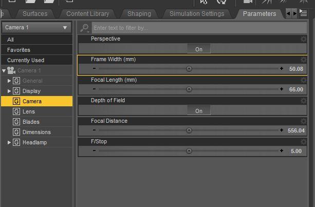

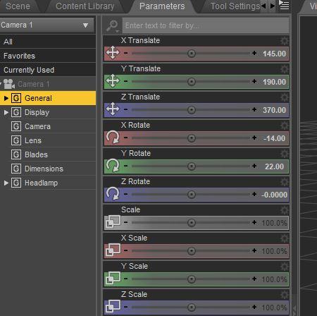

  • DekeSladeDekeSlade Posts: 127
    Here's the screencaps and reading the other posts.
    724 x 758 - 182K
    1200 x 768 - 1M

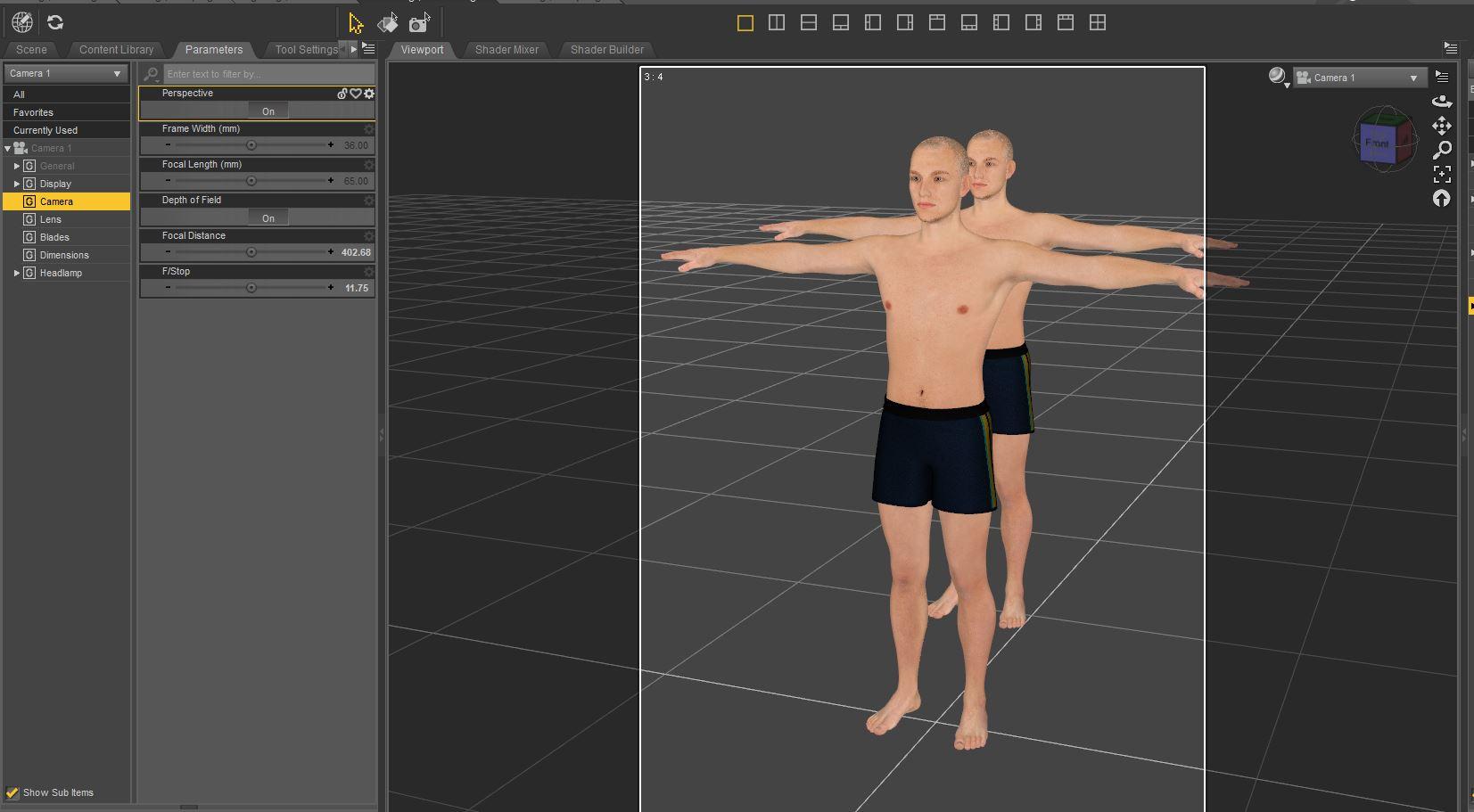

    edited August 2018
    Indeed it is.
    1188 x 947 - 555K
    Post edited by DekeSlade on

  • BeeMKayBeeMKay Posts: 7,019
    edited August 2018
    Muttley said:
    Indeed it is.
    That's good news, then. At least, DOF is working in your system.

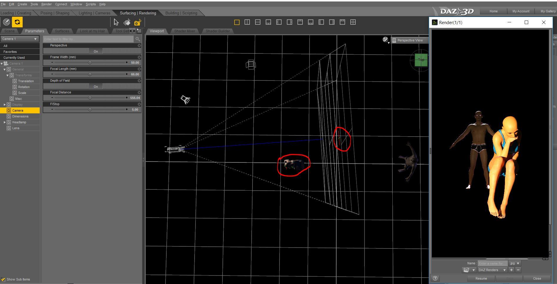

    I've tried to reconstruct the distances from your setting, but the focal point seems to place my character much further in the back than it does with the character in your image.
    1632 x 770 - 202K

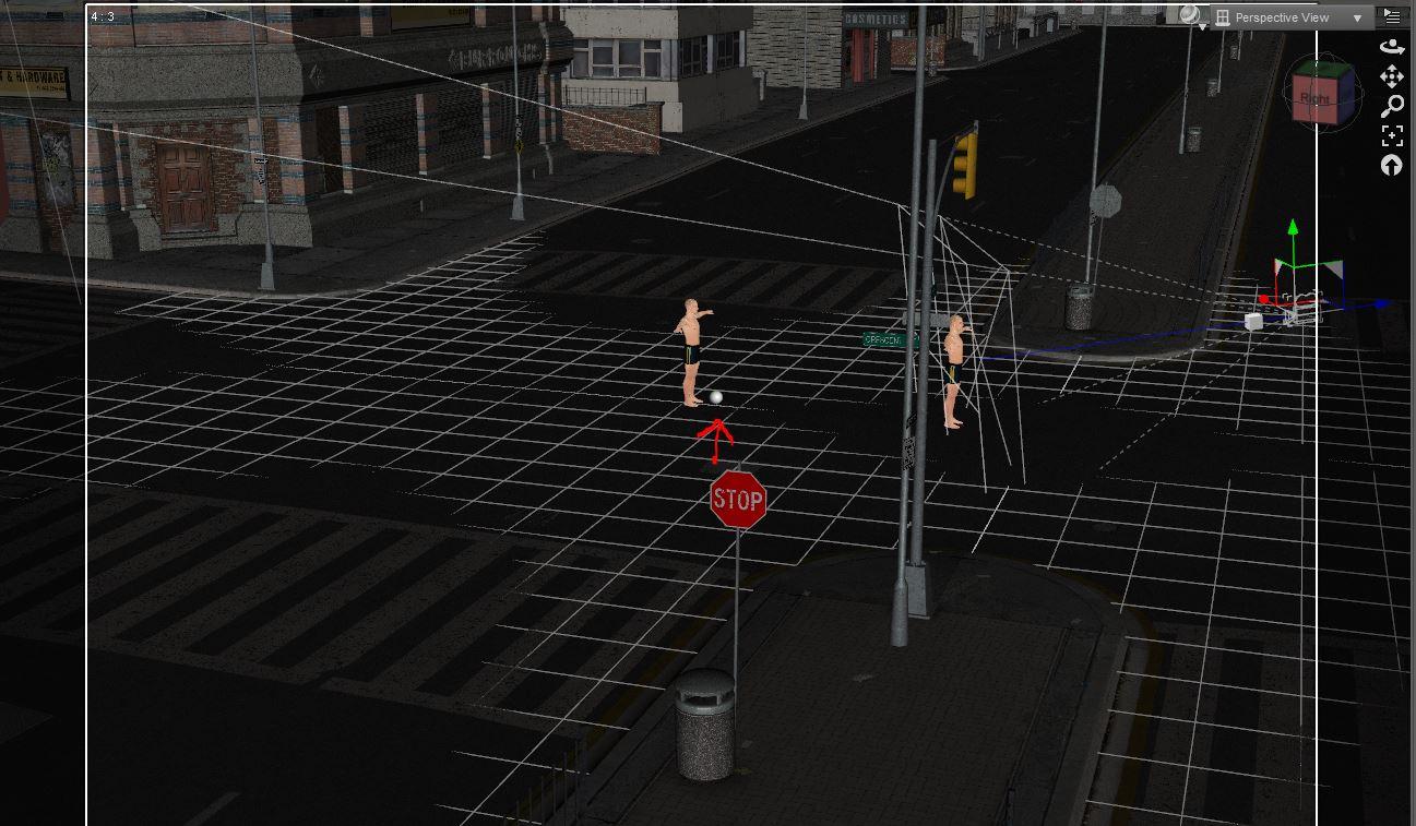

    For the one I posted I ran the camera in a bit and brought up the back light to try to better illustrate the point that both she and the background were in focus. Here’s a side view with all the settings as they are currently set, which I’m spinning in circles and at a point of diminishing returns so it may be even worse then when I started this thread. Regardless, she and background are still in focus =/
    2846 x 1936 - 1M

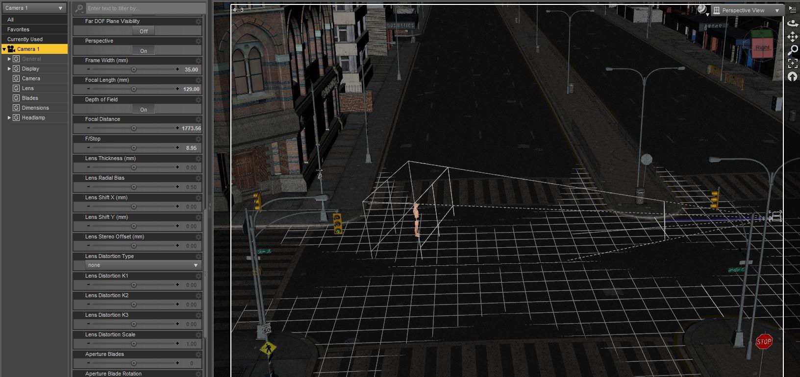

    edited August 2018
    As I thought... you focal distance and fstop are what is causing this.
    If I use your precise camera settings and pose the first figure where you have posed yours, my background is not blurred in render:
    That is because your focal point is way behind your character, but the character itself is still on the edge of the focal sharpness section, so it is sharp, too.
    With your scene and camera position unchanged, try these settings below for a start (changed focal point, changed fstop value), and then work your way from there by slowly increasing fstop:
    Keeping my fingers crossed that it will work!
    edited August 2018
    Did you click on the little eye symbol in front of the camera? And I just realized that the FOV LENGTH (a bit further up in your settings, under FOV Opacity) should be 5.0 not 5.47, can you please chech that, and then try to move things again? Thank you and sorry.
    And switch of any fx filters like Bloom, for the moment.
    Post edited by BeeMKay on
    If by eye symbol you’re referring to in the scene tab then yes, the eye is on, open, enabled, pick the version that’s Daz appropriate. Did as you asked and still, or again, zero blur/Dof =/
    … oh so very very frustrating.
    edited August 2018
    Good. :-)
    And that is weird, really. As the DOF works on your system, so reinstalling them would not help.
    The focal point might still be too far away. Can you bring that closer to the camera? At some point, something should change in the blur.
    EDIT: I'd ask you to share an abbreved version of the scene (just the camera and a stand-in-figure exactly at the spot where your figure is), would that be possible?
