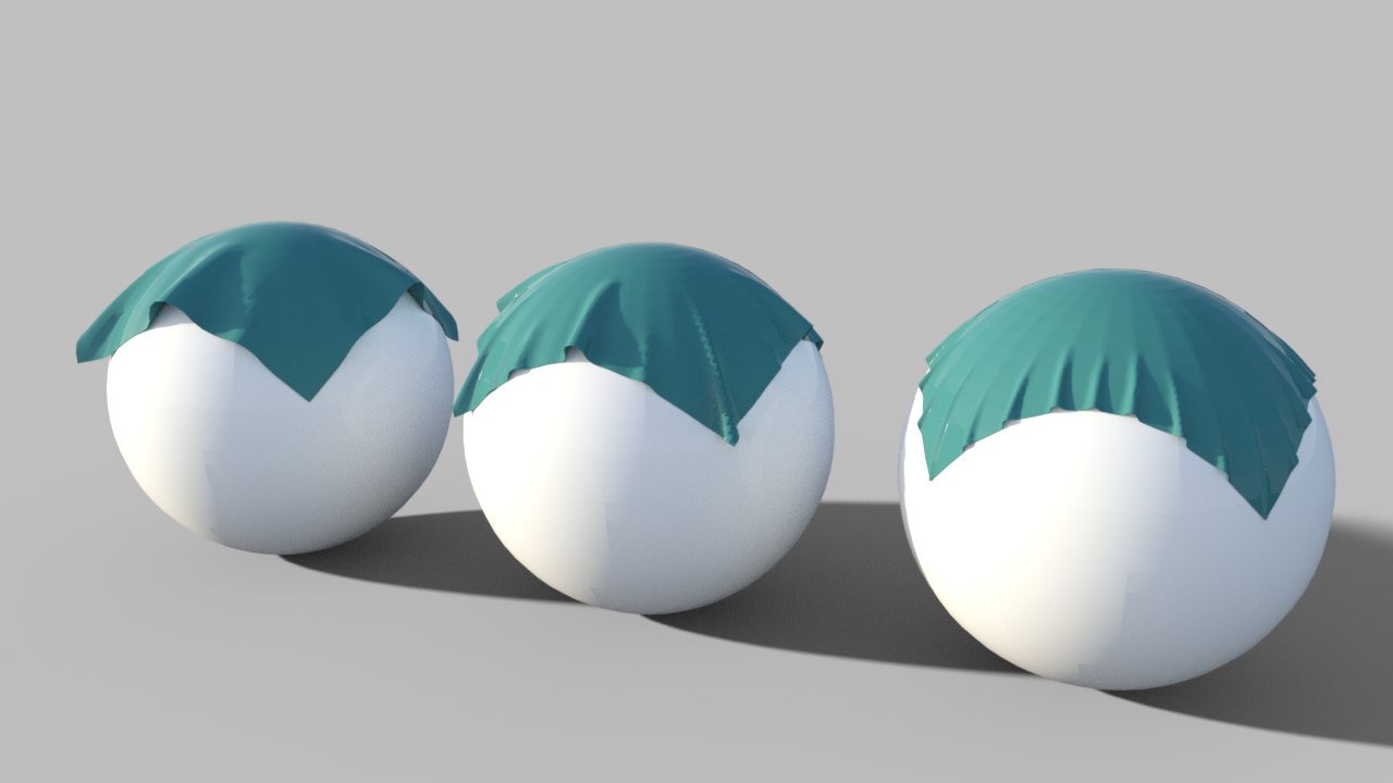

    Here's a quick illustration of what I was trying to explain before - from left to right, the plane has 32, 64, and 128 divisions (default surface simulation params for all of them):
    As you can see, the lower poly mesh is stiffer. You can control stiffness by varying the geometry density, but there can't be any standard surface parameters for certain types of cloth without a known, standard geometry density, if you catch my drift . . .
    Hope this explains things a bit better.

    That does explain things very well.  If I got a nylon fabric working well on a very dense poly model, and then someone tried the same settings on a less dense model, the result would be different. Thanks for that information!
    The fabric (cloth sim) is slinky on my current model because the poly count in my mesh is very high. I think I will retopologize it in Zbrush just to see the difference.
    Thanks
