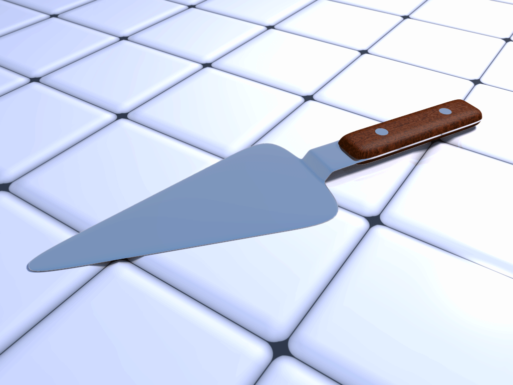

  • Retro LadRetro Lad Posts: 472
    I had some trouble understanding Carrara's texturing methods, but I finally cracked it so here is a mediocre Carrara rendering of my Hexagon spatula.
