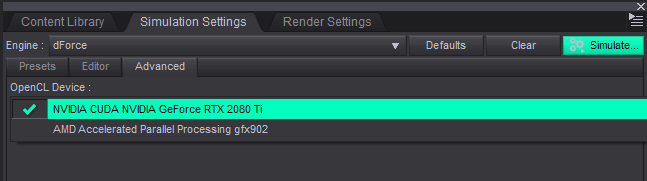

    How would you make clothing look correct when you can't use dForce because the entire PC is AMD?
    [edit]
    I have tried every AMD workaround that people have listed to no avail, it just won't work on my system.
    Post edited by pauldb13 on
  • WendyLuvsCatzWendyLuvsCatz Posts: 41,326
    edited October 2025
    odd because I used my Vega graphics the time Nvidia broke the driver for DAZ Studio by switching to AMD
    for Dforce that is, obviously not rendering except I did with Filament
    there is of course the option of using Blender instead
