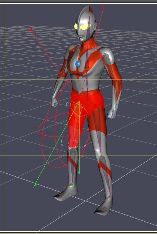

I downloaded a free figure, and I know you get what you pay for and I'm immensely grateful for this work someone made, BUT I was hoping to actually use this figure in the new user posing challenge for the month here at Daz. It works okay if you don't need to pose the right leg much, but I'd like the option. Anyway, if someone could tell me how to fix this, I'd greatly appreciate it.
When I select the right thigh and try to pose it, it does this:

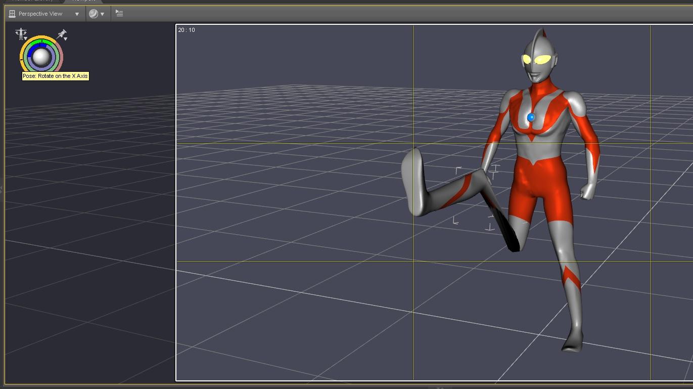

The lower leg moves just as you'd expect, but the upper leg stays pretty much fixed. In the wireframe view, the upper leg is where it appears to be, while the lower leg moves to where it appears it should if attached to the upper leg and the upper leg moved. If I raise the leg to a more extreme position, it does this:
As you can see, there is a deformity in the hip region where the upper leg should be, but the wireframe shows the upper leg is where it appears to be in the viewport.
What causes this, if anyone knows, can a noob like me fix this, and how?

  • murgatroyd314murgatroyd314 Posts: 1,569
    It looks like a rigging issue where they forgot to select the mesh to be influenced by the upper leg bone. Fixing it may be possible, but it's beyond my skills.
