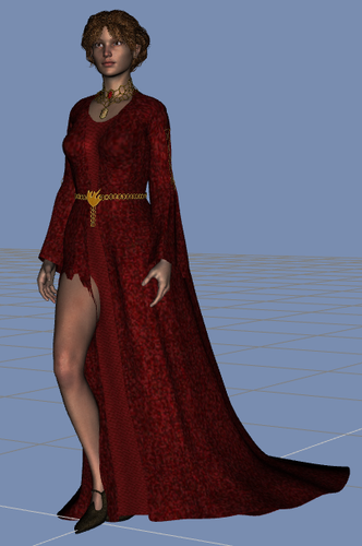

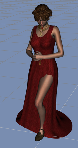

Hi,
I applied one of the V5 Base poses to V5 and the dress didn't conform. I tried the "fit to Genesis" and there is still the poke through. Is this supposed to happen? What can I do to fix this problem.
Much appreciated

    Looks like it's conforming but you need to pose the skirt handles. They are found under the pelvis usually in your scene tab. If there aren't skirt handles, look for morphs.
  • sinfanysinfany Posts: 190
    I didn't see any skirt handles. Where do I find the morphs?
    Look at the parameters tab. If that's Priestess for Genesis Females it looks like it has 13 movement morphs (according to the product page).

    Ok, tried that and it worked.
    Whew!!!
    Thanks
    It's something to keep in mind with pretty much every long skirt, no matter which character it's designed for. You're trying to get a one-piece skirt to move the same way as two separate legs with a hip between them — body parts on the clothes pick up their movements from exactly the same body parts of the figure underneath, and this mismatch in parts just doesn't work. "Ghost" body handles and built-in morphs are really the only way to get around this situation, and usually it needs a lot of fiddling with dial settings to get something that looks right. Short skirts are different in that they're usually easier to pose properly, but they do use the same workarounds as a longer skirt.
