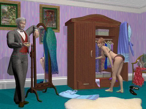

when clothing is not on a figure (say on a chair, or on the floor) how do you morph it to look realistic? I only seem to be able to flatten it by scaling in one axis, but it doesn't look very realistic as clothes are never just perfectly flat, yet symmetric in all other directions.
(I'm just talking about regular clothing btw not dynamic)
    edited June 2013
    With this one I flattened on the Z axis and then used some pose parameters to move bits around, in just the same sort of way I would pose a figure, if that makes sense. So the checked dress on the floor I bent the abdomen and then moved it sideways and a bit of twist in there as well.

  • SertorialSertorial Posts: 962
    thanks. I have tried that too, but most garments don't seem to pose very easily. Even if they have bones, they seem to behave in odd ways when I try to pose them...
    oh well... thought maybe there was some clever trick I was missing, but I guess not.

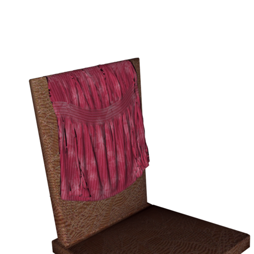

    You couldn't "fit to" a chair, I guess?
    You could try using a piece of dynamic clothing, and set it to collide with a chair, I'm not sure if that would work though.
    You could certainly do it in Poser with their dynamic cloth, using the cloth room.
    I just tried this with the Basic Dress for V4 (Dynamic), and set it to collide with a chair. It seems to work OK

  • ghastlycomicghastlycomic Posts: 2,528
    Lady: I'll just be another 5 minutes.
    Gent: You said you'd just be another 5 minutes half an hour ago.
  • pwiecekpwiecek Posts: 1,548
    If you have one scene with a garment being worn and want it on the floor later, try to find a similar dynamic piece and transfer the textures.
    edited June 2013
    Exactly. Is the image on the first page of my site, Seemed like a good idea for a site full of clothing textures.
