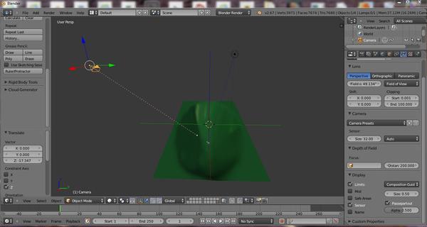

When I move the camera far enough away from the object, sometimes it fails to render. In this case I'm attempting to create a landscape. Is there something obvious that I'm doing or not doing to cause this?
Another case was a skyscraper I modeled. As I began changing the camera location, it eventually began clipping the building into a pyramid of sorts. What can cause these problems and how can I remedy them?
Here are two screen shots to check my settings. I've changed little.

Try changing the clipping settings under the camera's Lens settings, that should do it. You can see them in your first screencap.
Thanx, Tempest.
This is what often happens. I become perplexed by nothing working, post my query and, shortly before someone comes to my rescue, I pull myself out of the hole. I did that and, yes, it worked.

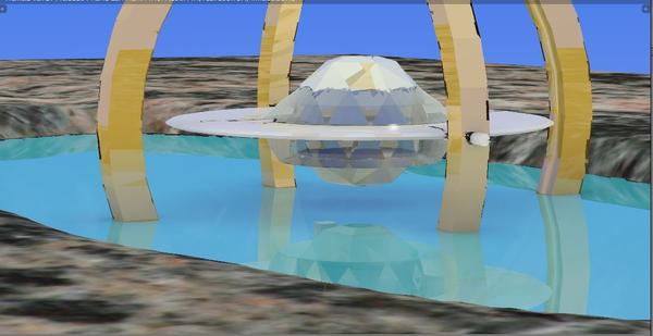

Here are some of the final results (likely enough to wing it through a brief presentation...) of this little project. Quite a few artifacts...
Any suggestions for a direction to pursue that will give the water reservoir some ripples? Turbulence perhaps?
Also, any ideas for curing the artifacts?

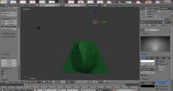

Let there be samples...
After watching a Blender Arsenal tut on cycles rendering, I learned how to increase the samples in "World" context. I increased the samples to 15. It took over an hour on this 2.0Ghz, 4GbRAM, 64bit machine, but some of the artifacts went away. The tut was about using Photoshop to eliminate some of the artifacts vs increasing render time.
I took a screen grab that shows some of the memory usage, verts et al. Better, but not perfect... yet.
