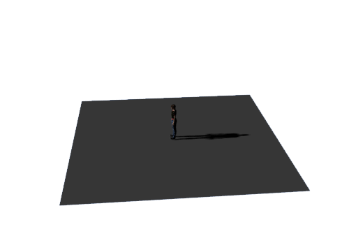

I'm experimenting with shader mixer, but i can't get the shadow without a plane.
I'm trying to get the shadow with this tutorial http://forumarchive.daz3d.com/viewtopic.php?t=116187
but i get the following result (see the image).
Please tell if there is any method to get the shadow without a plane.
500 x 348 - 7K
    In a word, no.
    DAZ Studio does not have a 'Ground' like Poser, so you need to use a Plane, or other object, otherwise there is no surface for the shadow to fall on.
