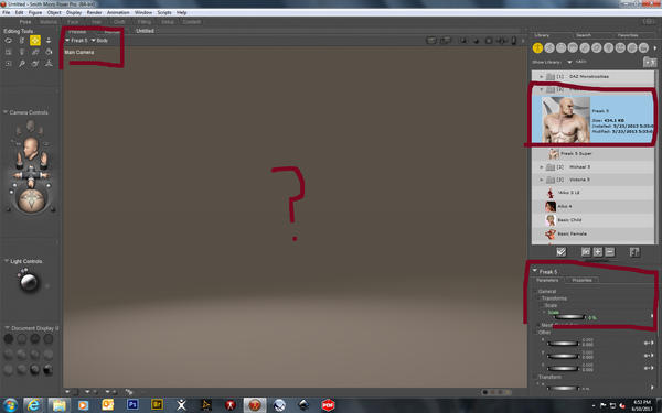

    I am using Poser Pro 2014 & have installed DSON - when I load the Genesis character it says it loaded but I don't see it in the scene?? Any suggestions please! I have tried to set Scale larger but figure never appears?! Thanks!!

  • LycanthropeXLycanthropeX Posts: 2,287
    are you using an external runtime? a fix i have used is copy the DSON files from the python script from the runtime where your Poser 2014 is install to the same folder in where ever your runtime is that you are using

    LycanthropeX,
    Thanks for the quick response. I just reloaded DSON to my external Runtime but still same issue- figure supposedly loads but not there? Guess I'll have to try a few things...ahhhhhh!!
    Thanks again!!
    try reinstalling poser with out removing the current installation. I have had to do that to get python scripts to work properly
  • fixmypcmikefixmypcmike Posts: 19,741
    Did you install Genesis Starter Essentials (both the main zip and PoserCF)?

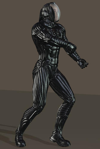

    I have noticed on some products if you just install the poser files you get the mysterious invisible figure problem, installing the Studio files as well seems to fix the issue. I have run into that at least 4 or 5 times.
    but i am having this same issue with the pit fighter outfit and so far nothing has worked to fix it
