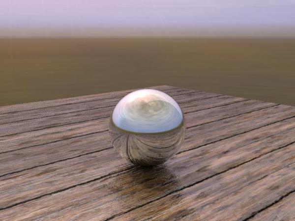

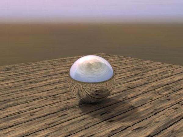

    Pics to explain what I mean by directional shadows, and example of an "average" hdri lighting effect from the environment
    Pic1 HDRI light
    Pic 2 HDRI plus a distant light
    you'll hopefully see that the HDRI produces a soft shadow from all round, but no directional shadows, or shadows with a defined edge or direction.
    The Distant light, creates Crisp, hard edged , defined, directional shadows.

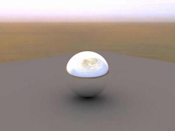

    But then your 3rd shot shows the issues with using secondary lighting. It takes some doing getting the HDRI shadow to blend with the light shadow.
  • 3DAGE3DAGE Posts: 3,313
    I agree Stan ;) LOL
    You need to adjust both to get a good mix of HDRi scene lighting, and the directional (Distant / Sun)
    I think the best way is to use "Soft shadows" on the directional light too, so it blends better with the HDR shadows, but still produces a directional shadow.
    Adding a shader / texture to the surfaces receiving shadows, will also help to make the "two lights" effect,.. less visible.
