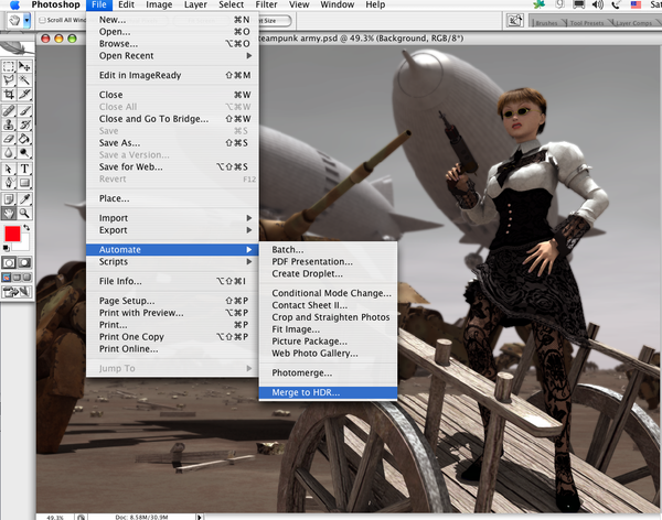

    Here's where to find the HDR function in Photoshop. I believe Andy said he had good luck using the exposure setting to manually adjust the "exposure" of an image and save several iterations to combine into the HDRI.

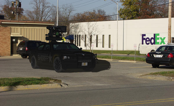

    You can pull it off mostly. The chopper picture and dinosaur pictures I posted in your other thread were minimally Photoshopped. Mostly to add film grain and other effects to help blend the 3D elements with the background photo.

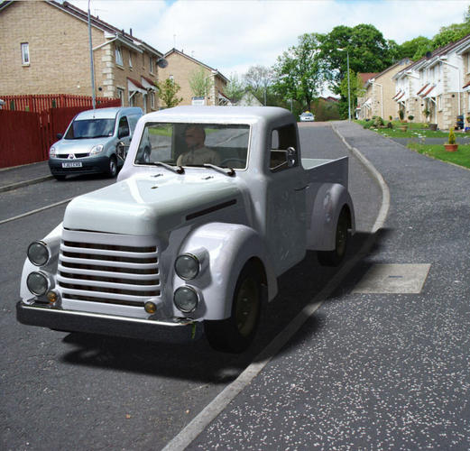

    The first image was done in C6 a long time ago,. using a photo in the Backdrop, and the same photo in the Background, and a Daz Truck with some planes and cubes with shadow catcher shadrs to fake the effect of the vehicle being next to the road edge / sidewalk (pavement in the UK)

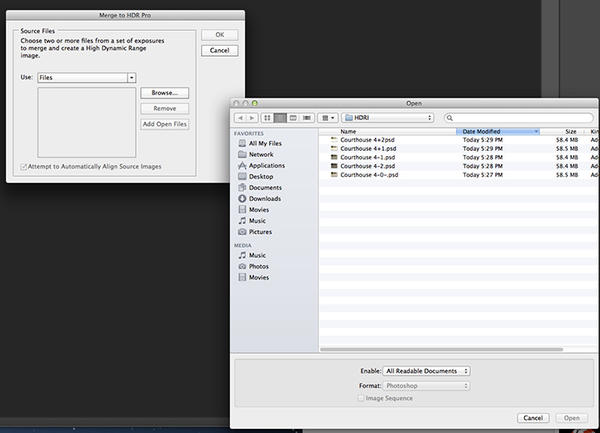

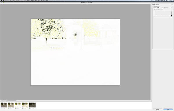

    Okay I have gone through this HDRI thing in photoshop and I must be doing something wrong PLEASE SEE IMAGES! I have watched many tutorial on youtube and still what I get sucks.
    Bottom pic is what the image should be

    I've posted this helicopter before, but I'll post it again. Click it to view the larger size study it. I used no Skylight or any other GI. The background was snapped with a crappy digital camera that uses .jpg compression.
    I used the image in my scene backdrop to line up the camera, lights and set my shadows. I then rendered it as a Photoshop file with alphas enabled. I didn't pre-multiply. I combined the background image and the helicopter in Photoshop where I added noise to the helicopter layer only to match the noise in the background photo.
    The scene used a few lights, a plane with a shadow catcher and volumetric clouds for the rotor wash. The main light was set up to mimic the sunlight (with soft shadows) and I had a couple lights to simulate the "bounced" light from the sky. I also used a light pointing straight up to simulate bounced light from the ground.
    Something you can do to help match the shadows in your picture and what your object casts on the shadow catcher is to adjust the main light's shadow intensity.
