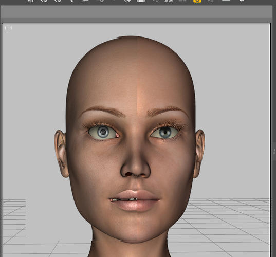

SSShader base- mouth looks open.. and other weirdness
Lissa_xyzLissa_xyz Posts: 6,116
I'm just getting back into DS after like a 6 month or so hiatus, and figured I'd give this Subsurface Shader Base a go, but as you can see, I'm having some issues. The left half is a spot render, the right is the viewport (does it too in an actual render). I've tried different skins/uvs to no avail. No idea what's going on. I didn't mess with any of the settings, except maybe trying to set the SSS to SkimMilk and Skin. I did peek at the Usage ReadMe, but since I'm not really sure what to call this problem, I'm not sure how to look to fix it. Any help is appreciated.
DS 4.6 64bit

    What exact character is that?

    I'm using the V5 Gabi char; however, I've tried it with both her own mat and a V4 UV/skin. I've also tried it with a random dialspun character and a completely different V4 skin.
    /edit
    It seems to be a hit or miss for me as I'm not getting the issue with Tamesis. o_O Do you happen to have both Gabi and Tamesis and could possibly tell me what may be causing it on one, but not the other? Whatever's causing it for me on Gabi may be the same issue on the other skins I get the problem on.

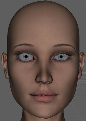

    I loaded Genesis, and then loaded Gabi from Genesis > Characters, I had previously had the SSS sahder loaded, but when I loaded the Gabi for V5 DUF file, it overwrote that, and applied the default DS shader.
    I loaded the SSS shader onto Gabi, and rendered, and I got the same as you, not much help I know, but at least it is happening to someone else too :)
    I didn't touch any of the settings for the new shader at all, and there is no Displacement being used. I am sure someone will figure it out for us.
    722 x 672 - 216K
    Thank you for confirming I'm not completely insane (at least in this regard). lol
