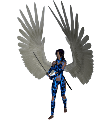

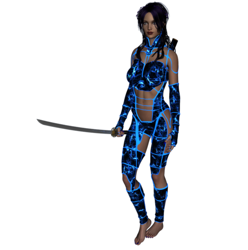

    This is what i started. its not alot of detail yet, as im trying to figure out how to get the right hand to grip the sword properly and figure out how to get her to open her mouth without her teeth falling out LOL!!! but im am having a blast just tinkering with the settings. what do you think Novica??

    I like the way she is gripping the sword up by the hilt (hope I am using the right term here) as it gives it a very secure feeling- like she has it well in hand. Now, my question is- are you going for relaxed? My first impression is she is not on a mission, she's just chillin' so to speak- and the feet reinforce that. One thing I would move is her left hand with the blue fingernail- you can't see it. That or change the color of the nails to a lighter blue or different color.
    Do you know how to slightly shut the eyes? They seem a bit staring, but that's just my opinion (and I'm seriously flattered you asked me, but you should be asking Chohole, Jaderail, Scott-Livingston, Totte, fixmypcmike...the list goes on!) I'd slightly shut the eyes and just see what you think?
    I love the outfit and the overall feel of it- you've done quite well! Have you practiced with lighting yet? (Meaning trying different ones?)
    Post edited by Novica on

    The standing position was the last position she was rendered in. It was late and I didn't want to reposition her for a battle stance. Yes you are right her eyes do need to be shut, looks like she is having a starring contest and hasn't blinked in a long while. But like I said its just the start, and little things like you mentioned are great. Thanks and hopefully I can make it better.

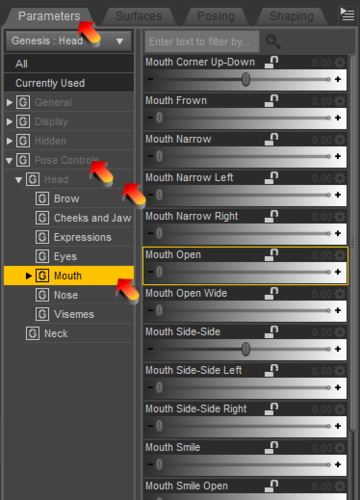

  • JaderailJaderail Posts: 0
    Here is how to pose the mouth, with JUST the head selected go to Parameters and follow the arrows. All the pose controls will list. You will not have all mine lists as I have some bought expressions installed.

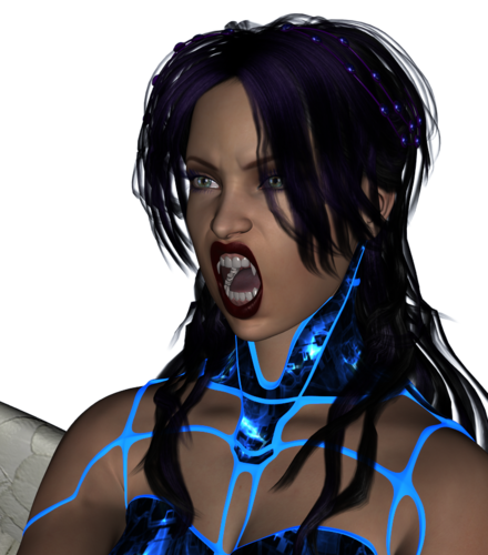

    Thanks Jaderail, i found them before i looked at the postings. I have altered the mouth the way i wanted. And added the last few things to start the image. She is a Vampire-Angel Hybrid. No Name for her yet. Im going to use her for a character in a novel im toying around with. Thought it might be easier if i could see the characters outside my own mind. And Cathie thanks for saying something about the eyes, i think they look a bit better now. Instead of looking hungrily at the guy with the cheese burger, she's going to eat the guy holding the cheese burger!! LOL
  • cj9831cj9831 Posts: 0

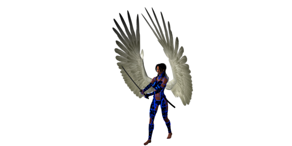

    OOP'S forgot the rendered Image!!!
    776 x 882 - 720K

  • NovicaNovica Posts: 23,925
    Oh yes, quite the difference!
    Next, do you know how to do the diffuse/glossiness to get the lips and the tongue moist? It's the opposite of what you might think- increasing the glossy number actually makes it less glossy. Don't know what you know, so I'll baby step it. Click on the surface selection tool (looks like three black sheets of paper) then click on the surface (tongue or lips) Go into Surfaces tab and experiment with the diffuse and glossy. I have some settings in my studio thread, but no time at the moment to go find them. I also suggested using orange for (I think) ambient to get a glow (very subtle)
    Really nice job dude!
