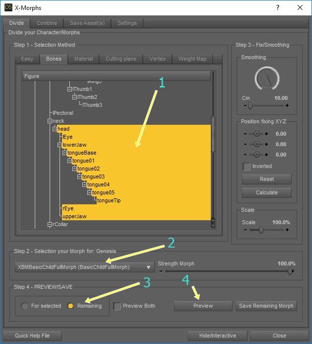

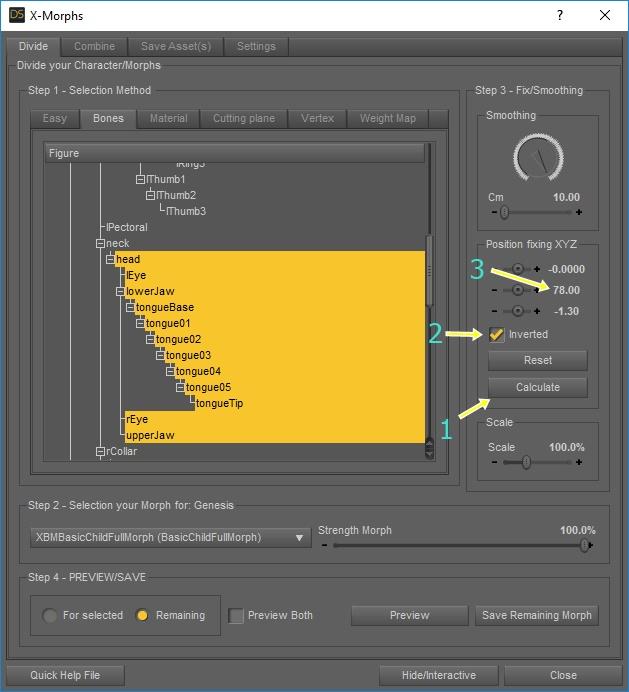

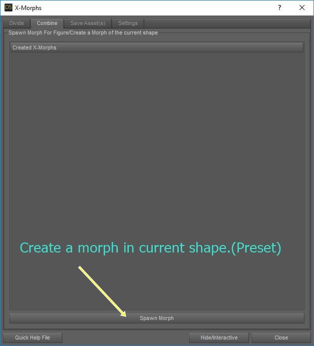

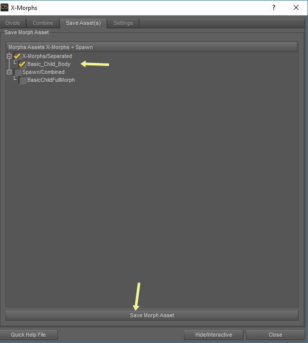

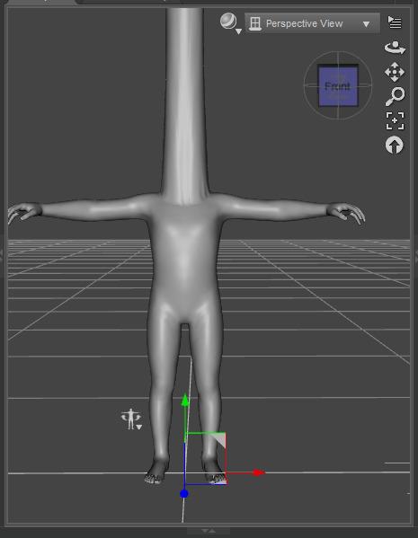

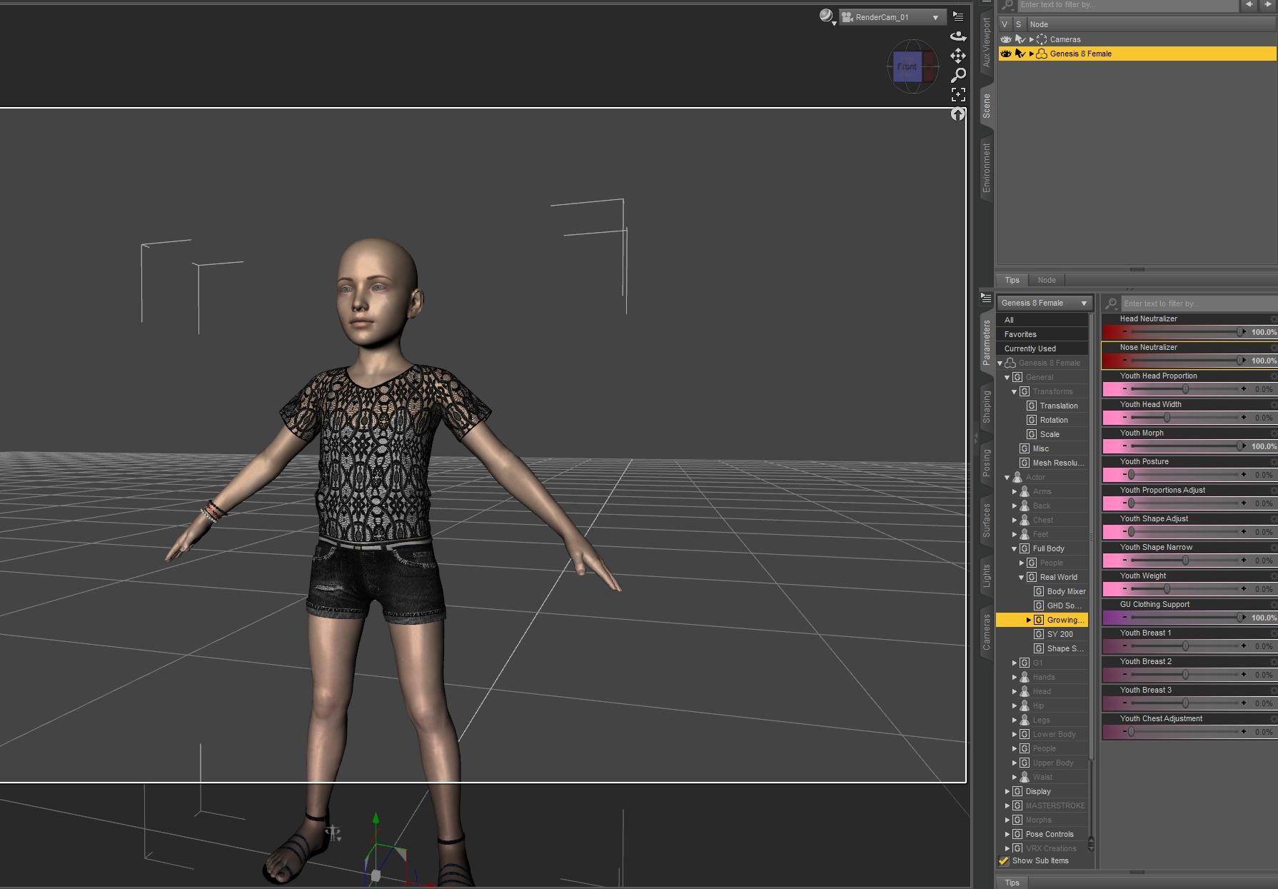

    These are the steps you should take to get the next result.
    1.- Load Genesis and apply dial "Basic Child".
    2.- Run X-Morphs and Click Spawn Morph.Combine, and save "BasicChildFullMorph" (It allows you to create a morph, with all the characteristics it has, such as the size of the character.)
    3.- In Divide-Bones, Select "Head" (childs), select "BasicChildFullMorph", select "Remaining", and Click "Preview"
    4.- To correct the position of the head, clicking on calculate.For this case, the Y position is manually adjusted to 78, for a better head position.
    The "Inverted" checkbox is very important, which allows you to move your head and keep your body in the same position.
    5.- Preview and test and Save Morph as "Basic_Child_Body".
    6.- Save Assets.- We save the asset so that it is available in the base figure.
