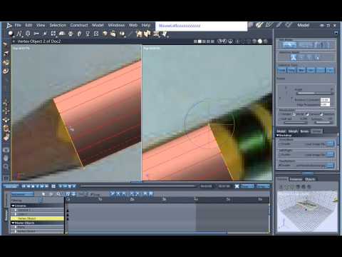

    In the model room, it rotates from the center of an edge Is thrre a way to rotate the edge around the end instead of the center?
    There is a way: select the edge, then Strg Alt click on the point you want to be center of the rotation.           Thanks to mr moir:
  • PhilWPhilW Posts: 5,162
    edited January 2018
    Ctrl Alt click (you put "Strg Alt click"). Good tip!
