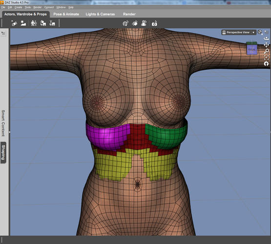

When I import the model, it fits very well on the V5 model, utill I use the Transfer Utility.
The model shifts down in the Y axis and don't understand why this is happening.
tI keeps the same form and shape, but is does not fit anymore.
Here are two screenshots of what I mean.
any suggestions would be helpful.

  • fixmypcmikefixmypcmike Posts: 19,744
    Make sure you scale V5 to 100% before exporting, then use Reverse Deformations when rigging.

  • Darth_SmeagolDarth_Smeagol Posts: 0
    Just checked and It was export @ 100%
    The first screen shot did not show up.

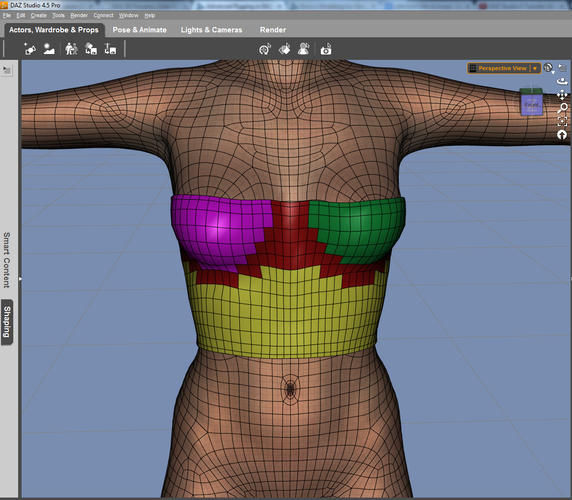

    Here's what it looks like before using the Transfer Utility.
    1166 x 1019 - 434K

    Assuming your clothes made for V5 morph, dial V5 morph and import the obj.
    Then in transfer utility, under Source select Genesis, Shape > Current, and for Target select the obj with shape -> Default.
    Press "Show Options" and select "Reverse Source Shape From Target"
    Also, you don't need to define lCollar, Chest groups, etc, only material zones. Genesis rig is of "one-skin" kind, there is no group splits.
    Thank you so much, it worked.
    I tried so many different import setting in the Transfer Utility, I guess I missed that one.
