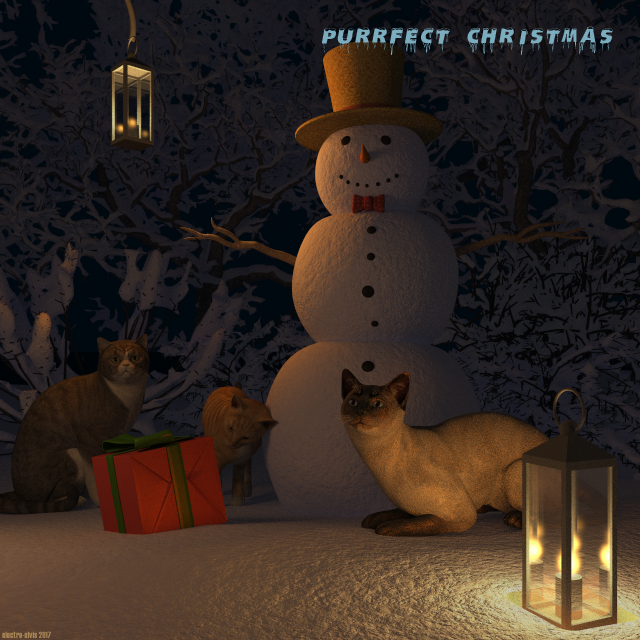

  • Electro-ElvisElectro-Elvis Posts: 951
    edited December 2017
    I think, I have found a suitable snow material. Of course the icing on the cake would be, if the snow glittered a bit, but I had no idea how to achive that.
    Nevertheless thanks for watching and Merry Christmas and Season's Greetings to everybody.
    Purrfect Christmas
    640 x 640 - 636K
    Post edited by Electro-Elvis on
  • SlepalexSlepalex Posts: 911
    Purrfect Christmas
    Alexander, very good work. But any work can be improved. You needed to make the main light cold, and left to leave warm. Then the feeling of winter and snow will be complete.
    To snow flashed under the influence of a light source, you need an additional light source with a procedural mask as a gel. Make a small diffuse value and a great specularity. For example, as in my first work. It is possible to include only this object.

    Electro-elvis: very nice Christmas render. I don't mind the warm colours. Of course, snow reflects the light it gets. For more 'sparkle' in the snow, I was indeed also thinking of more specularity. If you use a new light with only lots of specular light that works only on the snow (so exclude everything else), it might work.
    edited January 2018
    Thanks everybody for the friendly comments and suggestions, and especially slepalex for his examples. I will surely give them a try.
