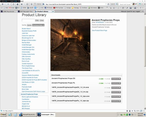

Does anyone know how to filter out D/S content from downloads???
edited December 1969 in Poser Discussion
I used to have only poser related files I downloaded showing, now I have a full on mess that makes no sense! How is a poser file listed now? And can I filter my downloads to only show poser products instead of every file? Thank you! See SS....

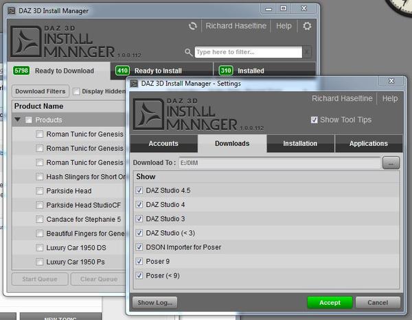

  • Richard HaseltineRichard Haseltine Posts: 111,364
    edited May 2013
    Install the DAZ Install Manager, enter your email and password for your account (the password isn't stored, just the email), click the gear icon at top-right of the dialogue and in the Downloads tab check the applications you want to see - files for the others (such as DAZ Studio, for you) will not show. The + button in the Installation tab lets you tell it where to install to - pick your Poser x Content folder.
    753 x 586 - 85K
  • WandWWandW Posts: 2,907
    Or if you just want to use it do download the files and install them manually, untick the Install Downloaded Content box and it will just download the selected files.

    I use Poser9. Could someone just list the file types that daz uses for the Poser program, ie., TRX. DPC, etc. I assume they must be .exe or .zip for my Win8 system. Below are a few files I would want to know if I should download to Poser9. Which ones should I choose?
    14498_KNickyHairforGenesisLegacy_v1.3_ds.exe
    14498_KNickyHairforGenesisLegacy_v1.3_ds.zip
    14498_KNickyhairforGenesisPoserCF_v1.3_dpc.exe
    14498_KNickyhairforGenesisPoserCF_v1.3_dpc.zip
    14498_KNickyHairforGenesis_v1.3_trx.exe
    14498_KNickyHairforGenesis_v1.3_trx.zip
    16107_AprilShowersPosesforGenesisFemalePoserCF_v1.0_dpc.exe
    16107_AprilShowersPosesforGenesisFemale_v1.0_trx.exe
    14975_EffortlessCoolGenesis_v1.1_trx.exe
    16169_MayDayforAprilShowersPoserCF_v1.0_dpc.exe PoserCF
    16169_MayDayforAprilShowers_v1.0_trx.exe
    I suspect that the EffortlessCoolGenesis can only be used in Daz Studio. Is that correct? Can I get a refund if that is correct?
    JC
  • fixmypcmikefixmypcmike Posts: 19,719
    If you use DIM, set the filter for Poser 9 and DSON Importer for Poser.
    If you want installers instead, you need the .exe files, trx and PoserCF.
    For Effortless Cool you would need to use DS to create the PoserCF's, or I believe there's a script to use them without PoserCF's.
