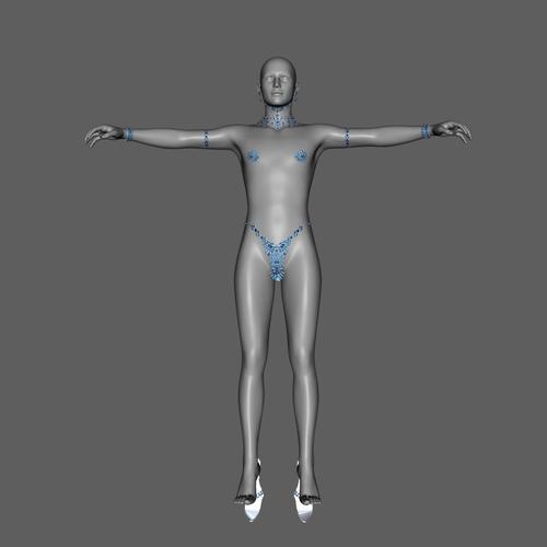

  • WendyLuvsCatzWendyLuvsCatz Posts: 41,872
    I thought the diamond dancer was for V3?
    No, it's for V1 & 2
    except for the shoes and one necklace. it does not conform too badly using V3 shape for Genesis

  • Richard HaseltineRichard Haseltine Posts: 112,142
    I'm surprised -people did try it ages ago, and it was held up as an example of something that would not take conversion. If it does that's great.
    I tried the VCFS too and a few other V2 outfits, you need to add a smoothing modifier and hide feet but they all worked.
