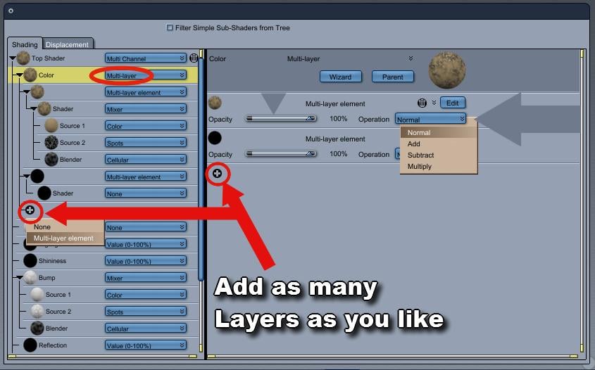

    But to change shaders during an animation, lets look at it three ways.
    The first is that we can change individual setting within a channel along the timeline - but I think you know that already. Simply open each channel that needs a change at the appropriate spot in the timeline, and make the change. But this only works for certain settings, like those that have a value input or slider, etc.,
    If we need to change something that otherwise cannot be edited, like swapping a Texure Map, for example, or even changing from Noise to Patterns, or whatever, we can use the Multi-Layer shader function (Operations > Mullti-Layer), which has an opacity slider for each layer - so we can use as many layers as we want and swap out function by altering their layer opacity. This method is REALLY powerful because we are not limited to how many things we change in one channel, and have incredible control over the change.
    The full blown (third) way is to actually swap shaders over time. I love that we can do this! ;)
    This method is nice because it's so incredibly simple compared to the above, second, method - although we can use that method in this method too! Check it out:
    With the first shader (in time) opened in the Texture room, and still at the Top Level, change the Top Level shader from Multi Channel to Multi Channel Mixer (Top Level > Advanced Operations > Multi Channel Mixer)
    Now that shader that we just had open will be Source 1 in the Multi Channel Mixer, which also has another Multi Channel Shader as Source 2, but it's just a blank default.
    Drag your second shader (the whole thing by dragging the Top Level) into the top level of Source 2
    To easier see what's going on, we can collapse Source 1 and Source 2
    We see under the two Sources that we have a third channel: Blender (or is it called Mixer?)
    The straight-forward way to blend them over time (the only way I've done it so far) is to use a Value 1-100
    When the slider is all the way to the left (0) we're using Source 1 at full strength, and Source 2 is not used at all
    When the slider is all the way to the right (100) we're using Source 2 at full strength, and Source 1 is not used at all
    Everywhere in between is a blended difference between Source 1 and 2.
