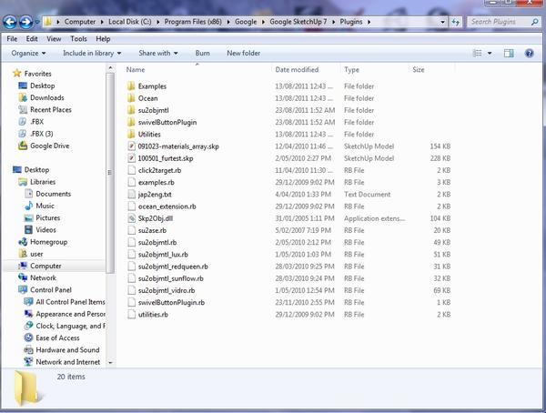

    it is a .rb ruby file that goes in the program files plugins folder
    my SU 7 with the Japanese exporter I have

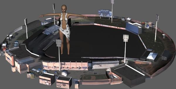

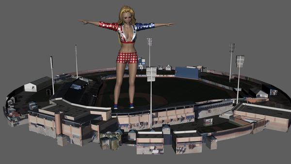

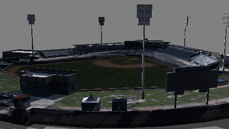

    the Seattle Giants stadium
    using the obj exporter I have
    native skp in iClone which imports them via iClone 3Dxchange
    dae from sketch up while it did not work in Daz studio, imported into Blender untextured,
    saving the dae export from Blender in the same folder as the textures loaded them into Daz studio
    2000 x 1125 - 507K
    2000 x 1125 - 425K
    460 x 259 - 1M
    2000 x 1125 - 643K

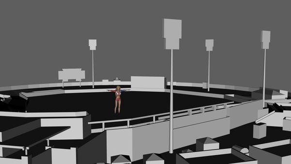

  • WendyLuvsCatzWendyLuvsCatz Posts: 41,809
    well I downloaded SU 8 and joined sketchucation and downloaded that ruby file
    buggy but works on some models, some others crash sketchup
    bit hit and miss
    that stadium worked and imported into Daz studio fine
