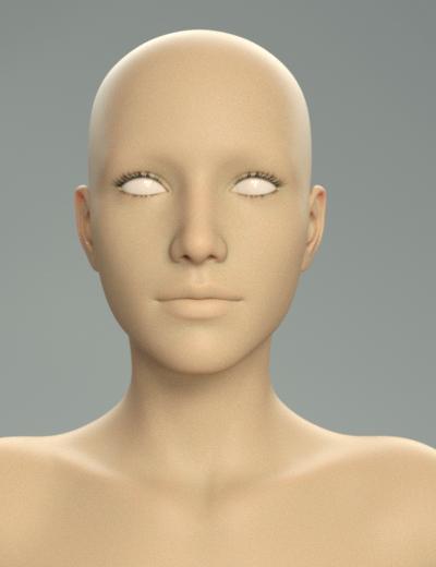

  • Just to ground the discussion (it seems to have wandered a bit) I have spent 30 mins converting an average V4 (Medusa the Gorgon) that I bought for a couple of dollars in the recent sale. I set up the skin according to the prescription in the original post, to wit:
    •  translucency 40%, scatter only, no translucency colour or map.
    • SSS transmission colour is blood red.
    • I disabled the glossy channel, put the specular maps in the Dual Lobe Reflectivity channel.
    • Substantial top coat to add a little sheen
    I  haven't spent time tweaking. SSS is very noticeable as a reddening around the edges of shadows (where it isn't masked by the reflected component). I might consider reducing the translucency to 30-35%. The eyes aren't great - they came with the model and I should have swapped them out for something less toony. The Dual Lobe Specular is "quite nice" and subtle in its gradations, but adds a huge amount of time to the render.
    My goal in posting this is to try to help anyone who is struggling with the look of a model - e.g. an older model, or even a brand new model like Monique 8. Just dive in, it ain't hard.

  • Valkeerie said:
    As for Monique 8: if you have the model, take a look and tell me what you think.
    I don't know, she actually looks fine to me. This is a Monique render, no color correction, default skin settings.
    Human skin does tend to come out a bit orange to me by default though, so I usually knock that out in Photoshop.
    I don't think translucency should be necessarily low. In human skin a high amount of light is actually scattered through the skin. About 94% of reflectance comes from SSS. Problem is, this really looks the most right with Chromatic SSS, and that is bugged to high heaven in DS. So often when I am setting up skin I still use mono SSS and lower translucency to avoid a single-color takeover of my skin. This is preventing me from developing and releasing skin shader settings right now, I really wish it would get fixed. :\
    600 x 780 - 767K

  • j cadej cade Posts: 2,310
    edited November 2017
    and because it comes up often in these sorts of threads... proof raising translucency doesn't intrinsically and always darken the figure. In this render the figure has their translucency set all the way on. Yes. 100% translucency, and yet no massive red, no darkening, etc. (no maps because I was doing a lot of expirimenting and I wanted to see what was going on without any distraction)
    (now because it uses all translucency and sss it is still quite slow to render)
    400 x 520 - 108K
    What do the same settings look like with 0% translucency?
