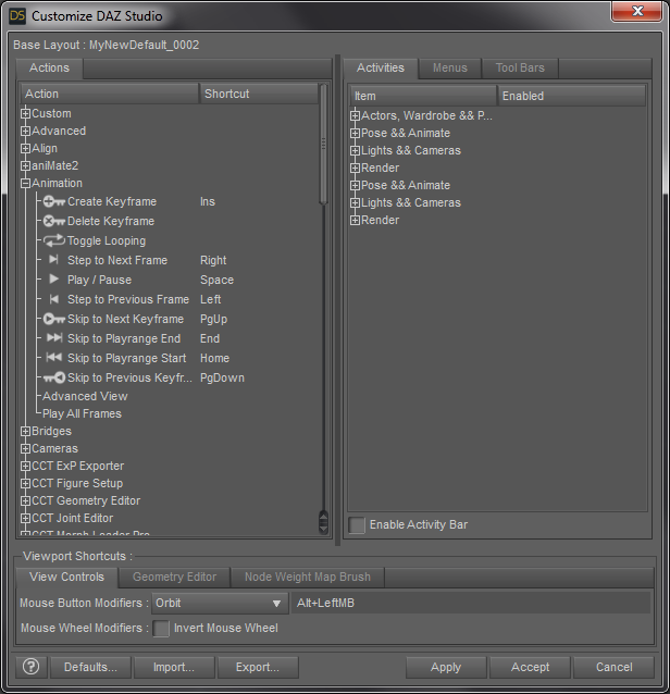

    But one day I thought of - damn why do I always have to click on the menu - so I decided to setup keyboard shortcuts for these most common used functions when I setup a scene with more than one KeyFrame.
    You can go to Main Menu: Window>Workspace>Customize and search the left side Actions List - right-click the desired action and choose Change Keyboard Shortcut.

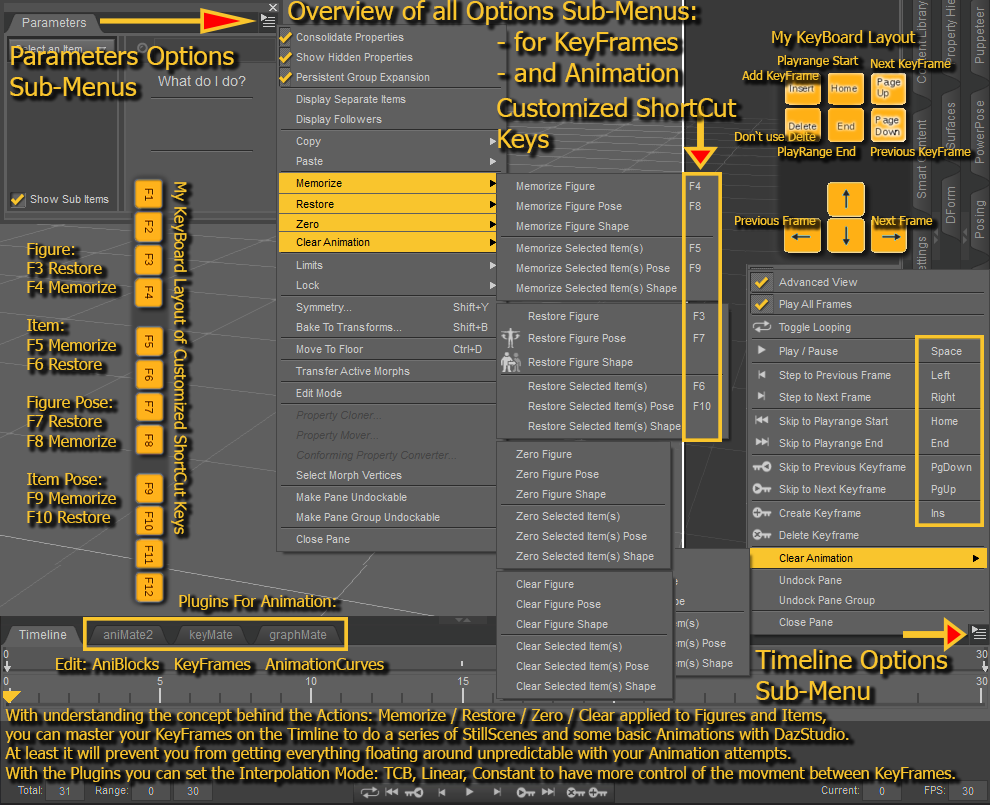

    It had to be something I can remember for shure since there are eight commands to memorize/restore Figure/Item All/Pose. See the screenshot for my layout: the memorize is allways on the outside with the gap in between - so my fingers cant miss even if I dont look at the keyboard.
    Now after I've learned how the program works - I teach the program how I want to work.laugh
    [Edit]: Updated the Overview of the Options Sub-Menus
    In Customize_KeysMemRstr_1.png you can see how I setup the Keyboard Shortcuts for Memorize-Restore Figure-Item.
    In Customize_AnimationKeys_1.png you can see how I setup the shortcut keys for the Timeline controls.
    746 x 565 - 136K

    Strange suddenly your attached screenshots apear, I didnt see them before. The picture of the Timeline with no KeyFrames (black triangles) showing reminds me of another thing that can trick you easiely.
    You may find yourself in a situation where you select the Figure and the Timeline shows no KeyFrames while its still animating. You may think this is a bug or it is spooking but just go to the Scene pane select the figure right-click and choose Select Children from the menu. This will select all bones of the Figure, the Clothes and the Hair that are/is fitted to the figure.
    And suddenly you can see there are KeyFrames that are stored on seperated layers like for the limbs / Bones with the Properties like Rotation/Scale and they are not stored / showing up in the Properties of the root node of the Figure. In this case you can use Clear Selected Items and it works even the bones are a part of a figure.
    The good thing about this is that you can make a specific selection on some bodyparts and clear just these animations from the timeline.
