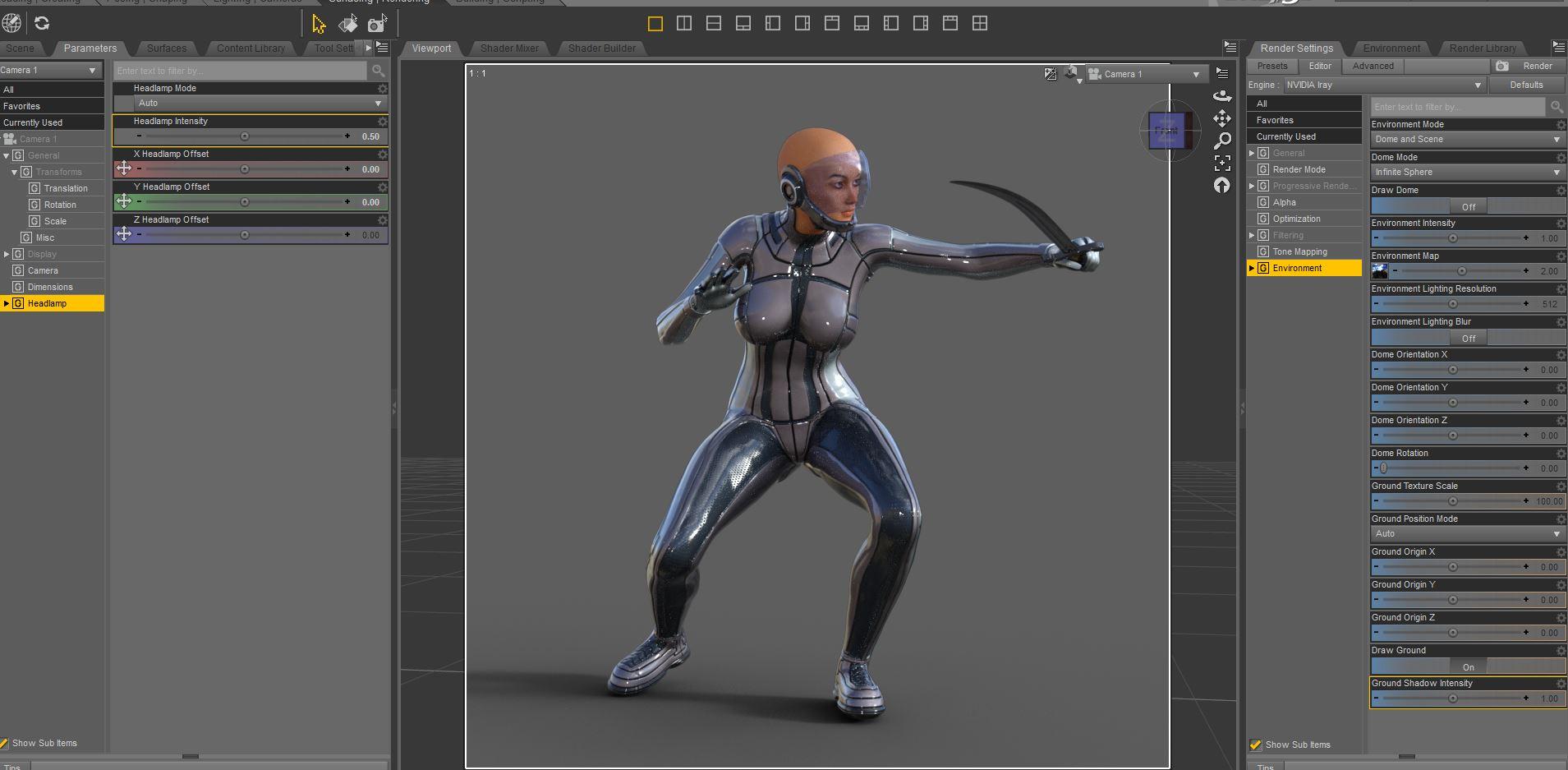

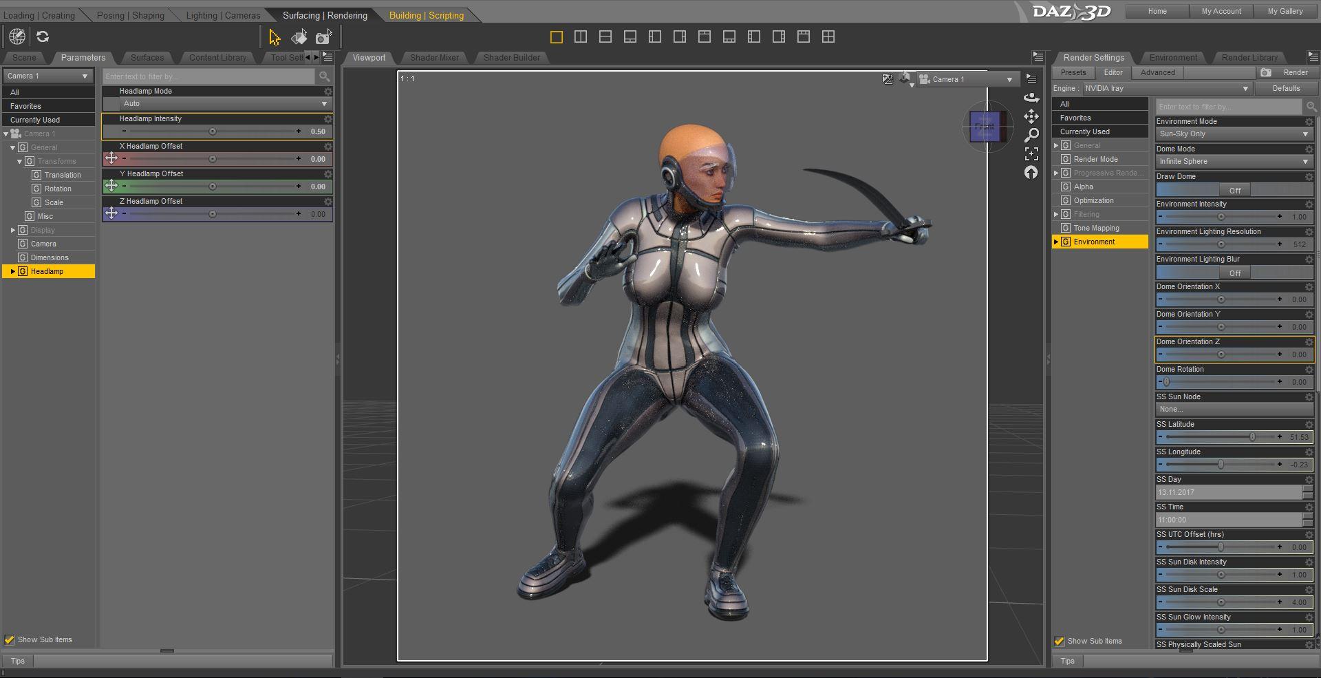

    You could use a combination of Sun&Sky setting (you have to experiment with the time of the day), and the headlamp that comes with the camera. The headlamp is usually a good light source when you tune it down from the bright-light 1.0.
    Here's some example renders and settings:
    Using the sun&sky:
    Using default dome&scene:
    As you can see, the different light sources have a different influence, i.e. when it comes to reflection colours on the bling parts of the costume.
