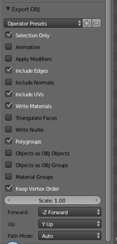

    Solnoid said:
    ...the default setting for export specifies that it will be exported with objects saved as OBJ objects. This little toggle is the problem. If it is unchecked, and the one below it (objects saved as OBJ groups) is checked, then the OBJ is exported with groups. However, the groups are NOT Blender groups! They will be exported assigned to each individual mesh in the scene.
    The polygroups option usually works for me. See screenshot below of my export settings.
    I feel your pain, it seems like I've spent years gradually learning this stuff, and am just now getting the hang of it.
    Hey, thanks! That's a big help.
    Blender has no real documentation for people who are wanting to use it for creating content for other programs, so having input from others is always great.
    ---Sarge
