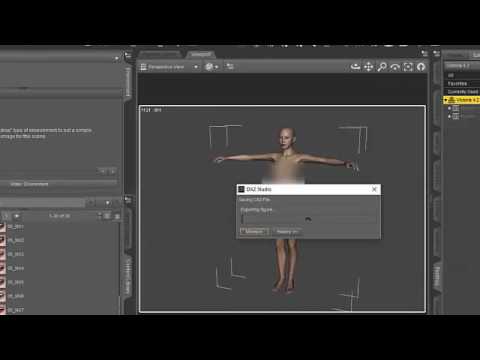

  • KlaudMKlaudM Posts: 76
    edited November 2018
    I tried with TT2 but doesn't work, I can apply only the basic surface for V4 to G8, instead when click to apply the LIE nothing happens.
    You have to save a V4 figure, with just the tatoo applied
    How? I tried to save it as LIE preset, Material preset, exported as .cr2, doesn't work.
    EDIT
    Browsing the folder with converted textures from TT2 I found the mistake, the LIE isn't applied, there's only the skin, so it's for sure a problem cause by this one:
    Singular3D said:
    If a map is missing it can easily be converted by assigning it as material/diffuse map in the right place to V4.2 before exporting it. This allows to convert any maps for Genesis 3, as Texture Transformer simply works on RGB files.
    I don't understand how to fix it, please check the attached screenshots. Where's the error?
    Seems like it doesn't support LIE.
    1156 x 1024 - 140K
    1696 x 1258 - 136K
    Post edited by KlaudM on
    Solved.
    Maybe for someone could be useful so here's what I did:
    - Converted the LIE in jpg, background black, tattoo white
    - Removed every skin map from the V4 figure, left only the Tattoo b/w
    - Saved as material preset
    - Converted with TT2
    - Applied on G8 as Overlay
