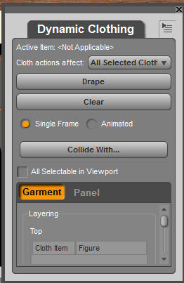

    I gather there are meant to be a whole pile of controls for the dynamic clothing tab (such as wind direction etc). Mine has none of them. How come?
    262 x 403 - 47K
  • JaderailJaderail Posts: 0
    edited July 2013
    Only the Pay for Dynamics version has All the controls, DS ships with Basic Dynamics built in.
